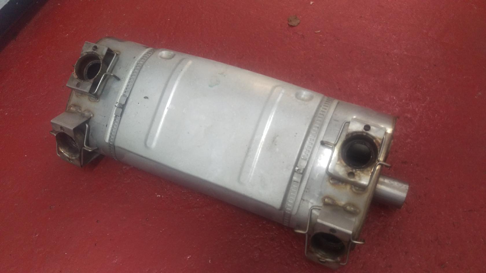

The Tri-Gear XS I have taken over has a 912ULS Engine that was purchased in 1999, although I do not know if the Exhaust Silencer was purchased at the same time. I am trying to determine if SB12 needs to be undertaken on this Silencer. I have attached a picture of the Silencer, in the hope that someone can identify it, and let me know if SB12 needs to be done. I have spoken to Europa, to enquire about the perforated tube required (EX-SB12), but Karen does not know about this, or where it can be sourced from. I have carried out the suggested verification, and the interior of the silencer is smooth, suggesting the work needs to be done. Any advice would be welcome.

Bob, Andy Draper at LAA HQ might help. Mine needed the mod, the manufacturer CKT should be able to supply.

The silencer was manufactured by SKT. They were helpful in my queries on
the subject of SB12.

Thanks for the advice Alan & Alasdair, both Karen and I contacted CKT, and they have promised to send me the part FOC.
