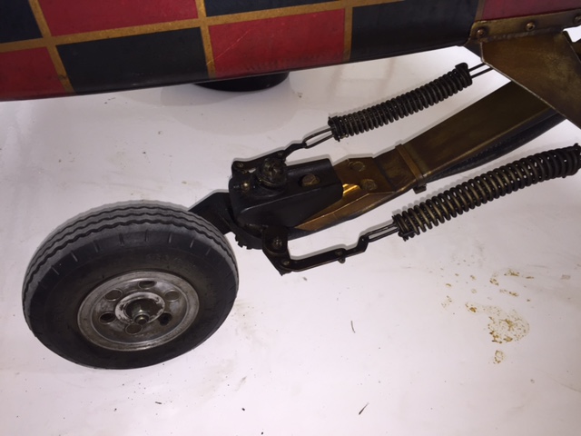

PostPosted: Wed Mar 02, 2016 3:06 pm    Post subject: Re: Yak 55 Matco tailwheel? Reply with quote
I have the Matco TW and have no issues with it. I also know someone that has some of the Russian pneumatic tires that might sale one. PM me if interested.
Don
