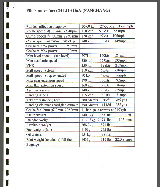

Attached is the manual pages I referred to above.

Hi;
I guess it's a good thing they came up with velocity table even if about 40
years late.
There are some interesting numbers there, particularly the gear and flap
limits. They show 170 Kph (gear) and 160 Kph (flap), not much different
than the original circuit limit of 170 Kph for everything.
If you would take another look at the new manual you may notice something
odd. (Kts. = Kph X 0.54, MPH = Kph X 0.642).
The VNE given is also interesting though for a different reason. It is
given as 350 Kph. which is the correct number as shown in the Technical
Specification Manual for
the CJ6. Strangely enough that was increased to 370 Kph for the CJ6A
(Ref. TSM pg. 191).
Perhaps they are correcting an error here as the airframe structure is
virtually identical and, IMHO, increasing engine power alone does not
justify an increase in VNE. Possibly just the opposite!
Cheers;
Walt

I should learn to proof read before sending rather than after! MPH = Kph
X 0.624 (not 0.642)
Walt
