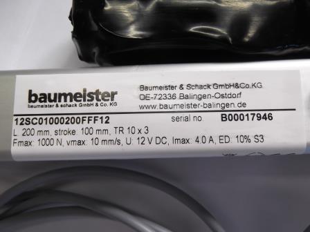

I have attached a picture I took of the flap motor before it was fitted.
Looks like the max current draw is 4 amp.

I'm going to use a couple of automotive electric window switches (rated 16A) for flap and pitch trim control and a suitable momentary button for PTT.
