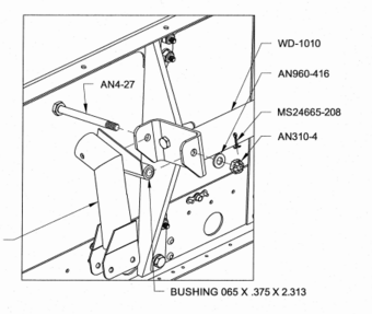

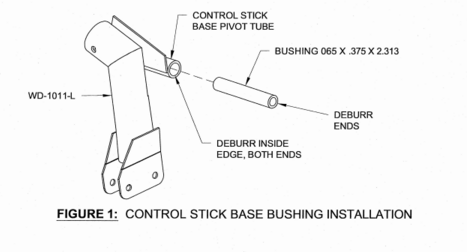

The dimensions are right in the plans, as the part number.
Bushing 065 x .375 x 2.313
Should be able to disconnect everything from the stick base, so that it
is only pivoting on the bushing, and then examine where the slop is. The
plans note that you may need to ream the bushing for AN-4 bolt. Best to
start with an undersize reamer. Note the tolerance for an AN-4 is as
small as 0.246. Perhaps a different, larger tolerance bolt might be what
is need. Range is .246 to .249.
Perhaps you could have done too much deburring on the bushing or ID of
stick base??
Steps 1 and 2 on page 39-8 are the key.

Are you talking about the OD of the bushing being undersized? I have
seen that before, although usually stick slop is because the bushing
is too long and the stick base can slide forward/back on the
bushing. In this case, just shorten the busing. If it's the bushing
OD, then the only option is to get a bigger OD on the bushing or a
new stick base and hope it fits tighter.
In use, you don't really notice it in flight in my experience,
although any excess movement will cause wear in the long run.

I thought I'd follow up on the control stick slop issue that I had in my system since I promised a post-bushing report.  I had some major play in my control sticks and ended up following Sean's advice and replaced the brass bushings with delrin.   I attached a couple of photos of the plans to help with the explanation.
After discovering the slop, I ordered delrin rods from Aircraft Spruce.  I ordered 3/8" hoping they'd be a drop-in replacement for a tight fit without any machining and 7/16" in case I had to machine them down to something closer to proper size for a good fit in the control stick base.  Each stick was about $3 for a 3 ft stick, so there was no harm in ordering both.
I pulled the sticks, stick bases, and control column out of the plane and put it on the bench.  On disassembly, I found that there was play between the brass bushing and the welded part of the stick bases.   I tried the 3/8" rod to see how well it fit and it dropped straight through unrestricted.  The inside of the welded stick bases were way more than the spec'd 3/8".  That was one part of the problem.  The other part of the problem was the slop on the inside of the bushing between the bushing and the 1/4" bolt.  That slop was worse than the welded part.  Additionally I found one more location for slop and that was the ability to slide the stick forward and aft on the 1/4" bolt between the stick bases and the control column that the stick bases mount to.
The first order of business was to get new bushings machined out.   Since the stick bases were more than 3/8" I used the 7/16" delrin rod and turned it down on a lathe that another guy on the airport had.   It was turned down until it was a thumb-press fit into the stick bases.
The next step was to drill and ream the hole for the 1/4" bolt down the center.   I initially tried to ream it to 15/64 (1/64" undersized for the 1/4" bolt) to get a snug fit in the event that the bolt was on the skinny side of the tolerance.  That didn't work out and I ultimately had to open it to a full 1/4" to get the bolt to slide through.
Back to the work bench where I installed the new bushings.  The fit was free of any play between that bases and the bushing and between the bushing and the bolt.
The final task was to eliminate the sliding motion of the sticks forward and aft on the 1/4" bolt between the stick bases and the control column.   This was a pretty simple task of inserting AN960-416 and 416L washers to shim as much of the gaps away as possible.   Obviously you can't get all of the gap out, so you have to take care of the last little bit by tightening the nut and pulling the control column in tighter on the stick bases.
I tuned this part of the system like you would a wheel bearing.  I rotated the sticks left and right while tightening the nut one flat at a time.  Once I began to feel tension on the sticks, I stopped and backed off one flat where I then dropped in the cotter key in to lock it into position.
The system linkages are tight (meaning no play) and very smooth (minus the drag of the TruTrak servos).  You can work the left and right sticks in opposition directions, like driving a bull dozer, and you won't find any play.   You can go all the way out to the control surface and hold it tight while wiggling the stick and not find any play between the control surface and stick.  I'm very happy with the outcome.
This wasn't a terrible change to make and if you have the seats out and access to a lathe, you could probably do it in less than a day.   You certainly could do it on a drill press with some forethought. creative jigs, patience, and a few sacrificed pieces of delrin while you traverse the learning curve, but the lathe is certainly the fastest and easiest.
I'd do it again...   Glad it turned out the way it did.

You want the pivot point on the bolt and not the steel welded part. That welded part isn't perfectly round (oblong) from the heat and it's also rough, abrasive, and susceptible to rust - contributing for abrasion and wear.
If you keep the motion on the bolt, you have a perfectly round and smooth pivot point. The nut is pinned so there's no chance of running the nut off.
Phil
