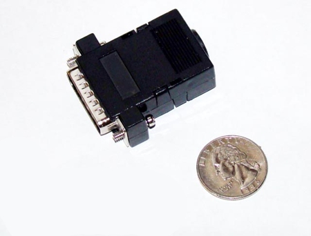

It can be done but it's a bit 'sloppy'. A short
time back we had an open-source project to craft
a programmable wig-wag controller.
http://tinyurl.com/d9q6ntj
I have one, proof-of=concept article left that
I'd make you a deal on . . . email me directly
if interested. This has been re-packaged and
will be the first AEC product to load on the
B&C catalog.
[img]cid:7.1.0.9.0.20160217104958.073e0e28(at)aeroelectric.com.0[/img]
If you're happy with the slightly larger package,
drop me a note.
