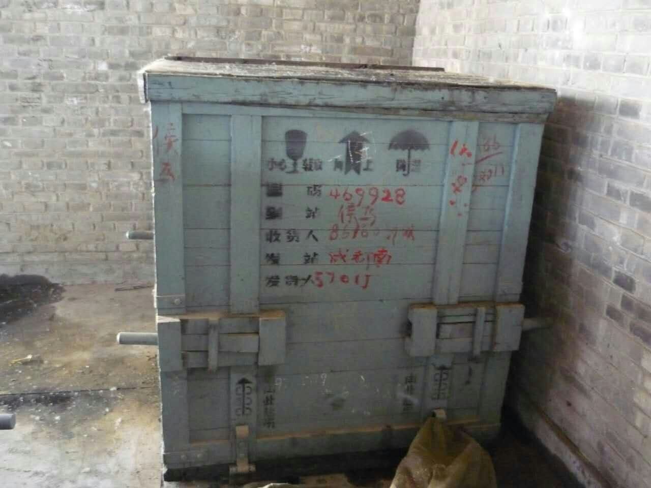

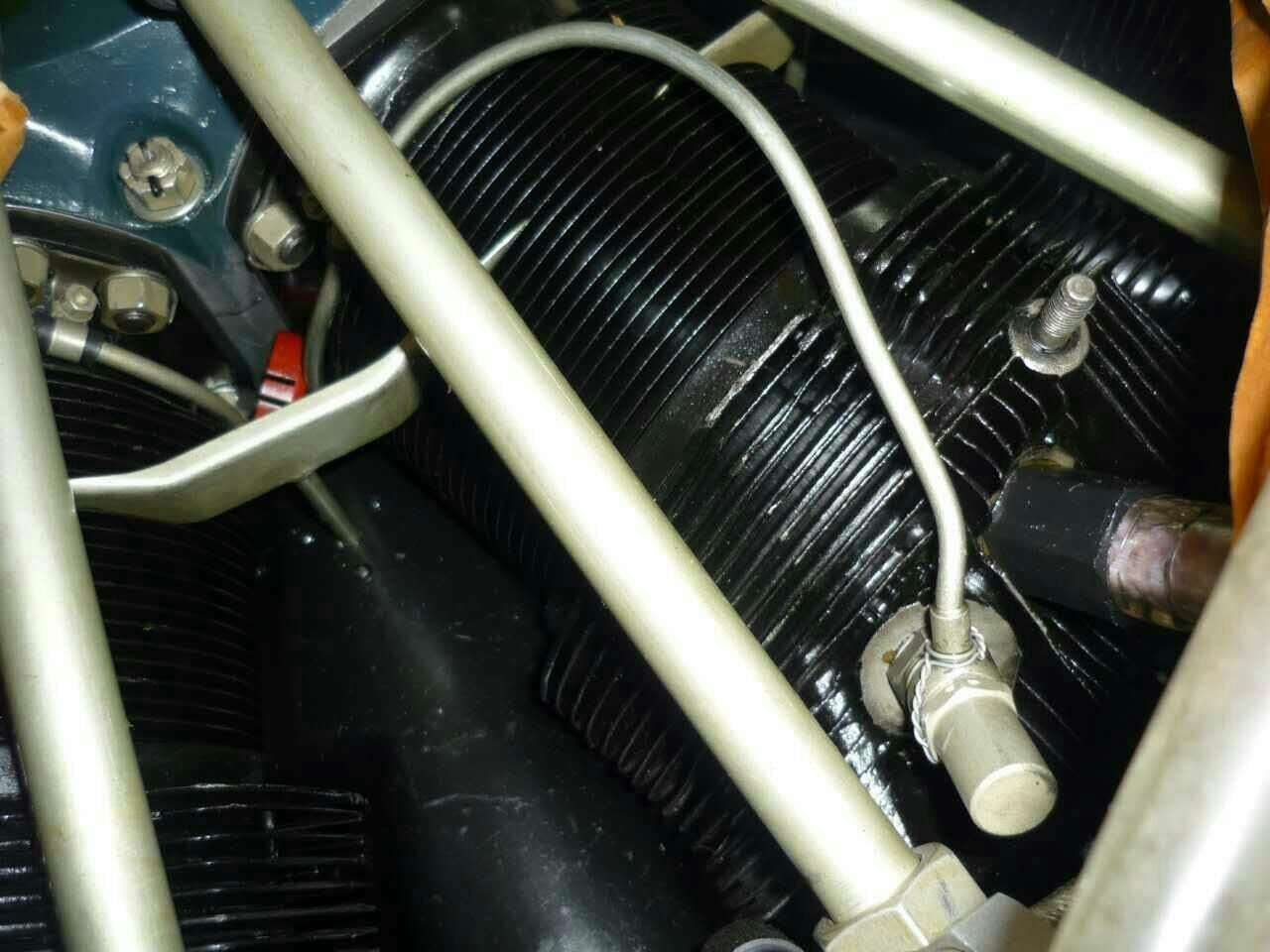

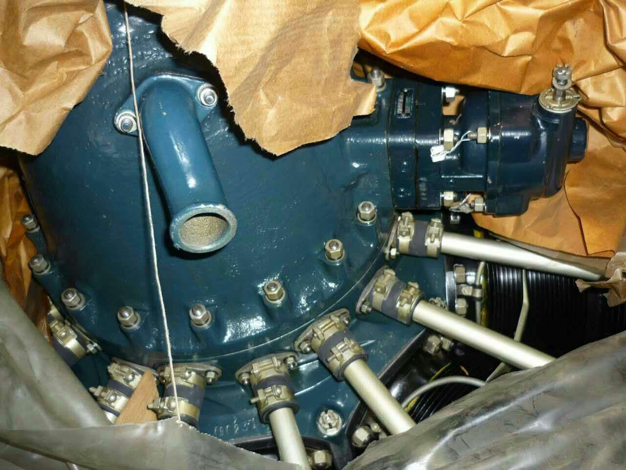

I received the following emails from Spencer who allegedly is selling a Housai engine. I believe others also received his email.
I told Spencer I have friend in China who can inspect the engine. He then ask me for a deposit before inspection. He sent me the following pictures of the engine he is selling. These pictures clearly are from different engines. I counted at least 4 different serial numbers.
BTW, he titled his email "Re: looking for an Housai HS-6D 300hp for a Nanchang CJ6 Aircraft."
Robin Hou
On Wednesday, January 13, 2016 9:31 PM, Spencer <pursehook(at)163.com> wrote:
Dear Robin.
Please see the reply as below with red words.
  1. Number of times your engine has been overhauled? one time
  2. What date was the engine last overhauled? 2012
  3. Has the engine been used since the last overhaul? NO
  4. What date was the engine manufactured? 2003
  5. Can you send me a photo? OK, Please see attached pictures
  6. The price is 15000USD/set, if you are interested, we can seel to you.
  7. The goods in Hebei, Till now, many buyers hope to buy
Best Regards
Spencer

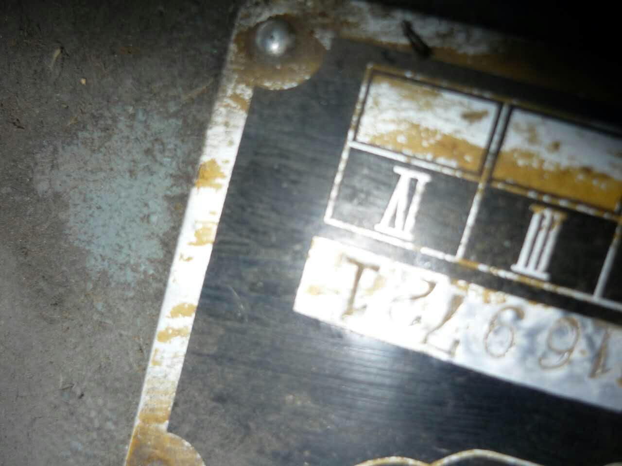

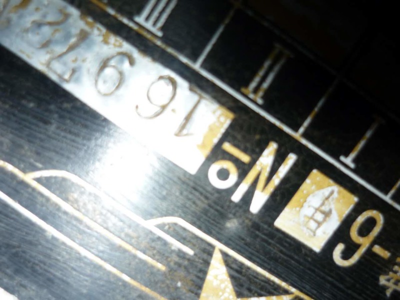

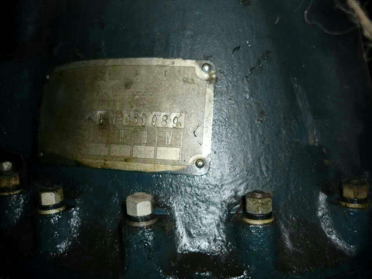

Hi Robin;
I count only three different serial numbers all of which were of 1969 manufacture, not 2003 as he stated. Chances are not good that any are “first overhaul”.
If you want to continue with him tell him to send you photo copies of the overhaul, test run and installed accessories certificates contained in the log book for each engine. With a translator these will answer your questions. Of course the logs must come with the engine.

Robin and WalterThis joker "Spencer", who signs off as Brian is a very naive middle man at best, at worst he is a thief.  If he is working you like me, he has most likely sent you a copy of the log,
in that log look carefully at the serial number (top left of the page).  Then go back to the photo's he sent to "prove" he has the goods and look at that serial number.
Please don't tell me that you are surprised that they do not match!!
First he wanted 30K, then it was 20K, "last" offer was 17K, when that was also refused he offers to accept my deposit for 10K with a guarantee to refund if the engine is not good.
Good luck to anyone thinking this guy or the engine is for real.
Robin Hou
