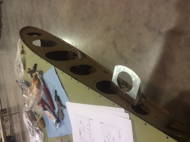

For those of you who have installed the magnetometer in the wing tip, are we all in agreement that the outboard wing rib is perfectly parallel to the centerline of the aircraft?
The Garmin magnetometer states that it needs to be within 1/2 degree of the centerline (much tighter demands than the Dynon) and I'm hoping I can base that centerline measurement off the outboard side of the wing rib.
Phil

I mounted mine out there, but leveled it with washers on the mounting bolts using a digital level.  Works great.
