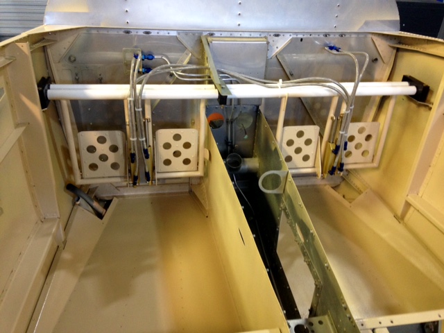

whodja
Joined: 27 Jan 2014
Posts: 50
Location: Apex NC (near Raleigh)
PostPosted: Mon Feb 22, 2016 4:31 am    Post subject: Re: Bonaco Brake Lines Too Short! Reply with quote
I installed my Bonaco brake lines a couple of weeks ago and they fit perfect. Call Brett to confirm the lengths that he sent you.
Bonaco brake lines installed
 Filesize:  105.69 KB
 Viewed:  7618 Time(s)
