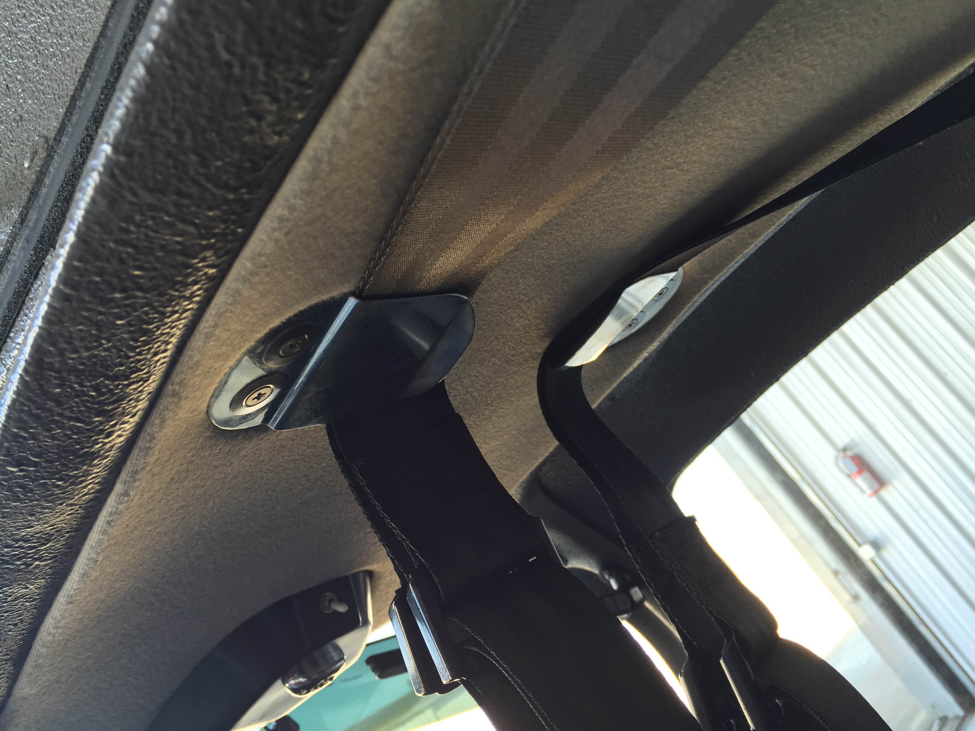

PostPosted: Thu Feb 11, 2016 12:44 pm    Post subject: Harness Strap & Headset Bracket Reply with quote
Here's another version.
--Dave

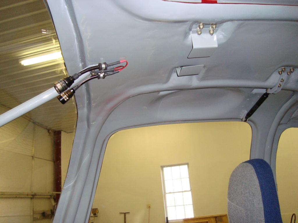

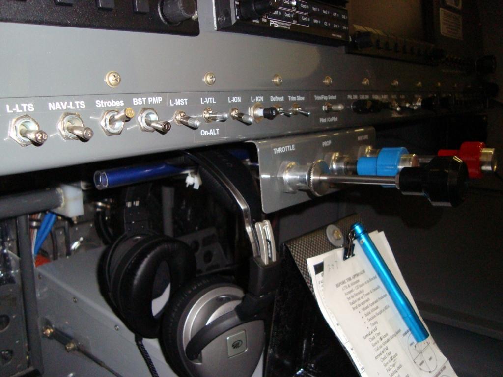

KWVI
carl.froehlich(at)verizon
PostPosted: Thu Feb 11, 2016 1:01 pm    Post subject: Harness Strap & Headset Bracket Reply with quote
Here you go.
Carl

On 12 Feb 2016, at 01:10, Carl Froehlich <carl.froehlich(at)verizon.net (carl.froehlich(at)verizon.net)> wrote:
Headsets holders are above and on either side of the tunnel on a simple single piece of ½” aluminum tubing attached under the panel. The ends of the tubing have a few inches of plastic hose to protect the headsets.
Harness strap holders are Z brackets made from .040” aluminum and attached to the inboard door hinge screws on each side.

Com'on builder, you can make your own belt hangers. Try these - they look good and work even better.
Someone suggested hanging the front seat headsets on the side underneath the panel. Out of sight and sun yet easily accessible if you get them before belting in. I made a hook with a piece of aluminum tubing and blind riveted to that first vertical behind the firewall.  And when flying solo, no action required for the unused headset.

<Seat Belt hangers.JPG>
<Headset holder.JPG>
