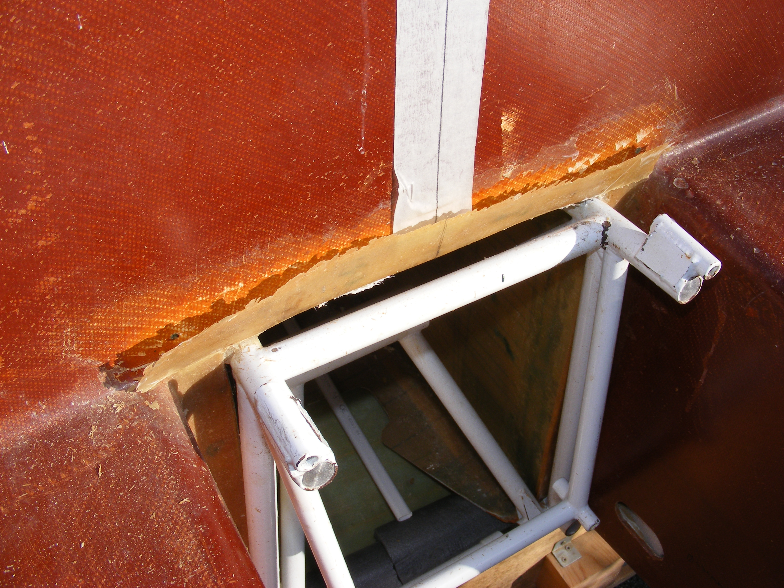

nigel_graham(at)m-tecque.
PostPosted: Mon Jan 25, 2016 1:07 am    Post subject: Filling on top of gel coat. Reply with quote
I just want to second David's comment (2) on scuff sanding.
The wing mouldings are very thin and it's easy to inadvertently cut through the structural weave if you're over zealous.  Use only 200 - 400 grit "wet and Dry" abrasive and look to achieve a "flat" finish.
All the pre-moulded components were delivered with small amounts of release agents still coating the surface. If you are in any doubt as to how effective this is, take a look at the attached picture of a de-laminated firewall to tunnel reinforcement. There is no sign of the firewall having been prepared - it is still "shiny" and the resulting lamination has not bonded. I was able to slide a steel rule under one edge and "unzip" it.
This aircraft was built by students studying for a degree in aerospace engineering at a renowned university ..... which doesn't say much for the quality of instruction or inspection.
I can't really name the university, but if Sir Geoffrey was alive today, he'd be turning in his grave!
Nigel

PostPosted: Mon Jan 25, 2016 4:50 am    Post subject: Filling on top of gel coat. Reply with quote
My first attempt at the firewall reinforcement looked like that despite the fact that I had scuffed it - obviously not enough - which taught me the lesson.
And David I did wash it first because you put the warning about the release agent on an earlier post.   I find the forum extremely useful given that I am a long way from in person advice.
Will
