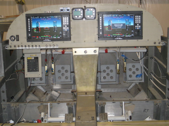

I went with MGL (http://mglavionics.co.za/) ..... probably too early in my build, since there's been a lot of new models to choose from.
There were two main selling points ..... the ability to customize my screens (there are 9 of them) and the RDAC which mounts inside the engine compartment and gathers all the engine sensor data so only three #22 wires go through the firewall.
I chose the Odyssey 10" panel because I'm old and don't see as well as I used to.  GPS, autopilot, AOA, altitude encoder..... everything but radios, transponder, compass and AHRS is integrated into that panel.  CAN bus, RS-232 and 'airtalk' communicate with external boxes.
I chose to make the two panels 'independent' with their own compass and AHRS which cost a little more than backup round gauges.  My panel is removable as you see it here with harness plugs on the far right and left using a combination of 'D' and Molex connectors.  I can power it up on the bench and install new equipment if needed.
They also have autopilot servos that will handle the stiff RV-10 elevator.
The downside ......
Rainier, the chief designer, is pretty much a 'one man shop' ..... there are others working there .... so new products are 'his' designs, and there may be a long wait for 'bugs' to be fixed .... especially in the older product lines.
If you have specific questions, I'll try to answer.
Here's a pic of my panel ...... The only thing missing is the Trig transponder which is below the left radio.  Lots of progress made since this pic was taken.
[img]cid:part1.06010004.05000005(at)cfl.rr.com[/img]
Good luck with your decision ..... it's a tough choice for all of us.  Make sure your panel meets the 'mission requirements'.
