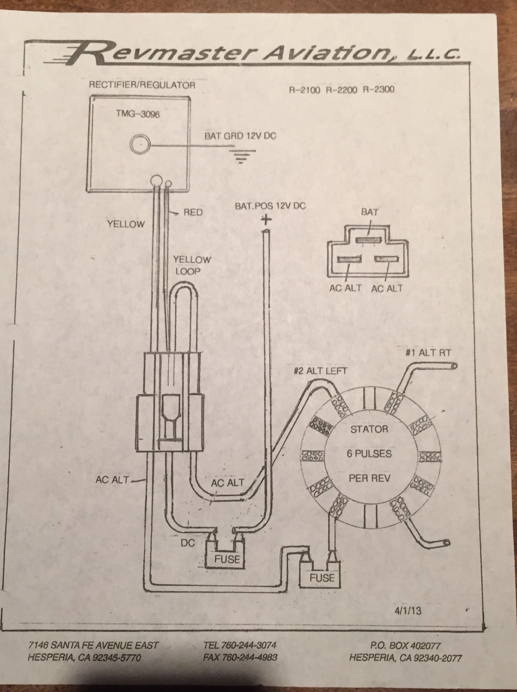

I'm building a Onex that takes a VW engine. The engine is a Revmaster which has two 20 Amp PM generators housed in the accessory case. I believe the output for each would be single phase. I read that the PM alternators generate variable voltage based on RPM. I am hoping to use a Lithium battery which has a maximum charging voltage of 14.7V. Would like recommendations on how to create a reliable and safe combination of elements. I have built an RV9A using Aeroelectric guidelines for the electrical system and created a totally trouble free airplane. Hoping to do it again with the Onex but cannot find the relevant information. Need help.
Paul

PostPosted: Tue Jan 12, 2016 12:03 pm    Post subject: Schematic for twin PM alternators Reply with quote
The Revmaster comes with very basic installation instructions.  They have a schematic showing the two output wires going to a rectifier/regulator TMG-3096 with a fuse on one leg of the output.  I have been unable to find anything on this rectifier using Google.  I am concerned about keeping the voltage within the requirements of the Lithium battery, any requirement for automatic shut down, connecting the two alternators to a single battery, etc.
Paul

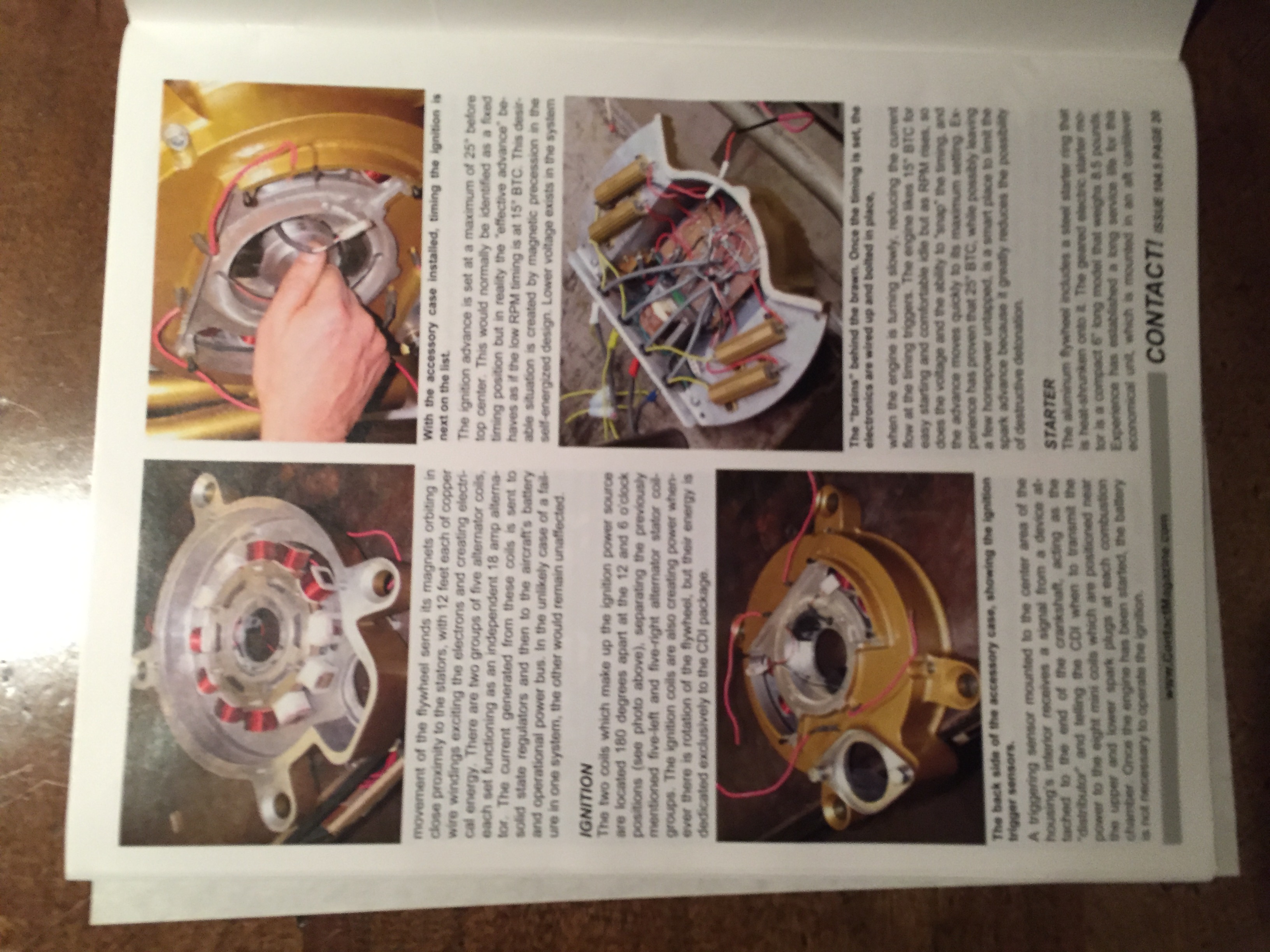

Here is a link to an easy to read pdf of the Contact article that Paul mentioned above.
http://www.contactmagazine.com/Issue80/Issue-80L.pdf
Paul,
Looking at the Revmaster wiring picture, I am completely stumped. I have no idea how it can work wired that way. It appears that one of the AC wires is connected directly to the battery. And why isn't the second alternator being utilized? Most builders would love to have a second free alternator with no added weight. All I can suggest is to call Revmaster and ask their advice. If they offer no help, then I suggest that you use part of one of Bob Nuckolls' diagrams that contains a Dynamo with over-voltage protection. He offers his book for download free.

Agree that contacting Revmaster is the best 1st action. Ask for a real
schematic, in addition to the hookup cartoon. But the way I read the
drawing, they are showing 1/2 the system, with the other half 'implied'.
It looks like the alternator is wired to operate single phase, with one
end of the coil (actually three coils; unknown whether they are series
or parallel) having one end ground referenced and the other feeding a
diode contained within the regulator. The 'bat pos 12v DC' lead is
likely 14v, otherwise it won't charge the battery.
The book Joe references has a drawing that shows how to set up
overvoltage protection.

PostPosted: Thu Jan 14, 2016 1:07 pm    Post subject: Schematic for twin PM alternators Reply with quote
At 09:58 PM 1/13/2016, you wrote:
--> AeroElectric-List message posted by: Charlie England <ceengland7(at)gmail.com>
Agree that contacting Revmaster is the best 1st action. Ask for a real schematic, in addition to the hookup cartoon. But the way I read the drawing, they are showing 1/2 the system, with the other half 'implied'.
Agreed . . . I'm not sure 'we know what we don't know' about
this system. I've e-mailed Revmaster requesting copies of the
installation manuals for their full line of products for

PostPosted: Thu Jan 14, 2016 2:03 pm    Post subject: Schematic for twin PM alternators Reply with quote
Joe  Thanks for the links.  I see a number of schematics for PM alternator based systems.  I need to study each and then make a list of components and questions.  I'm sure that what I need will be based on what has already been done.  Charlie is right that the other alternator hook up is same as what is shown.  Bob is asking about manuals.  I don't think that either Sonex or Revmaster has manuals beyond the very basic.  I believe they both use a non-adjustable rectifier/regulator with no further controls other than fuse and switch.
Paul

PostPosted: Fri Jan 15, 2016 6:54 am    Post subject: Schematic for twin PM alternators Reply with quote
At 04:02 PM 1/14/2016, you wrote:
Joe  Thanks for the links. I see a number of schematics for PM alternator based systems. I need to study each and then make a list of components and questions. I'm sure that what I need will be based on what has already been done. Charlie is right that the other alternator hook up is same as what is shown. Bob is asking about manuals. I don't think that either Sonex or Revmaster has manuals beyond the very basic. I believe they both use a non-adjustable rectifier/regulator with no further controls other than fuse and switch. Â
It appears that Revmaster has incorporated
TWO stator windings not unlike those on the
Rotax 912/914. Further, I read references
to alternator outputs of 18A and 18A, and 30A
in another place.
When offering this 'novel' product, it is
incumbent on the producer to describe its
capabilities, limits and recommended
integration techniques.
It's pretty cool that the manufacturer
has been able to up-size their DC generation
capabilities . . . the 912/914 has been
sota gasping for watts since day-one. On
the other hand, just how one integrates
TWO separate sources is unclear.
Does anyone on the List have a factory
installation manual for this engine? Those
excerpts in Contact are, as some have noted,
more confusing than illuminating.
I will suggest that studying anything published
in the 'Connection will be of limited value
until we understand exactly what's installed
on the engine and how the manufacturer intended
that it be used.

Attached is a drawing that I made of a possible way to wire the Revmaster dynamo. It is based on limited information available about the Revmaster. Suggestions and criticism welcome (as long as you are not too hard on me). Smile

I do have the Revmaster installation manual and the picture previously sent of the stator connections to the rectifier/regulator is the only reference to wiring the alternators.  I believe it is intended that both alternators feed the battery at the same time.  I do have a few questions:
What is the downside of both alternators connected to the battery at the same time.
What is the purpose of the capacitor.
If the crowbar disconnects a generator from the battery what happens.  Is there any harm to the generator.
If the outputs from both alternators are exactly in phase with each other, then I suppose that they could be connected in parallel to a rectifier/regulator. The alternators may very well be in phase (if the wires are not connected backwards) because they are excited by the same rotating magnets. I do not understand how the alternators are connected to the rectifier/regulator in the picture that you posted. AC voltage can not be connected directly to a battery. The AC needs to be rectified and regulated first. The alternator coils can be damaged if not wired correctly. The trial and error method should not be used.
The output voltage from a rectifier/regulator is pulsing DC. A capacitor tries to smooth out the pulses. A flywheel on an engine is analogous to a capacitor in a circuit. They each smooth out pulses.
I do not think so, but will leave that for others to answer.

Interesting blog about connecting home generators in parallel:
http://yarchive.net/car/rv/generator_synchronization.html
Most of the cautions and concerns described in that blog do not
apply to the Revmaster alternator because the relative speed
(frequency & voltage) and phase angle between the two windings
never changes, due to the common permanent-magnet field.
Before connecting the Revmaster alternator windings in parallel, it must be determined that the two windings are in phase and not out of phase.
The blog describes how to do that.

The energy considerations for the Revmaster dual
alternator windings includes questions like
are the two outputs in phase with each other?
Are they the same magnitude? If so, the
system integrator might consider simply paralleling
the two windings and feeding them into a VERY robust
rectifier-regulator . . . I think there are some
small tractor products that are rated in the
30-35A class . . . a pair of 18A stators would
challenge such a device . . . if they even
exist.
A low-risk approach would be to treat the two
as separate alternators each fitted with its
own r-r. Okay, now you have to decide if
the two outputs will be simply paralled to the
same bus . . . or perhaps configured as a 'mini-
Z14" system. One of the two might drive the
main battery . . . the second could be paired
with a similar or smaller battery.
A energy study on installed dual alternators
would explore whether they are sufficiently
matched to simply parallel to a single battery/
bus. This is probably the most attractive
option for a small airplane. You would want
to load the system well into the upper regions
of capability and check to see that both
systems do a reasonable job of sharing loads.

I don't understand the comment about the two generators being in or out of phase.  If they are both run through a rectifier.regulator wouldn't that eliminate the phase concern.I looked at a schematic for a Lockwood AirCam.  This has two Rotax engines each with magneto, rectifier/regulator, and capacitor all tied into one battery.
