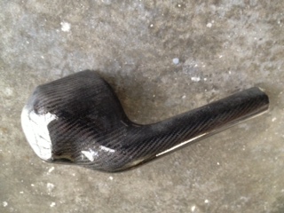

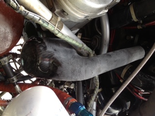

Does a cooling shroud for the air compressor exist for the M14P?  Perhaps something similar is available from the CJ operators?  I'm a new operator of a Yak 55 in Arizona, and I'm wondering if improved cooling would be a good idea for our high summer temperatures.Thank you!

It does exist, John. Built of carbon fiber by a skilled fellow at our airport. It was modeled after the M-14P shroud on a Yak 18T.
I know that Ian Burnham, the builder, was close to creating a mold from which he could product more. He can be reached at aerobuild(at)msn.com and (707) 975-0199.

Doug Sapp has a cooling set for the CJ that works on the YAKs

Is Doug Sapp on this forum?  Does anyone have a picture of his set-up?

Yes and no. Just have one of his for the 5
