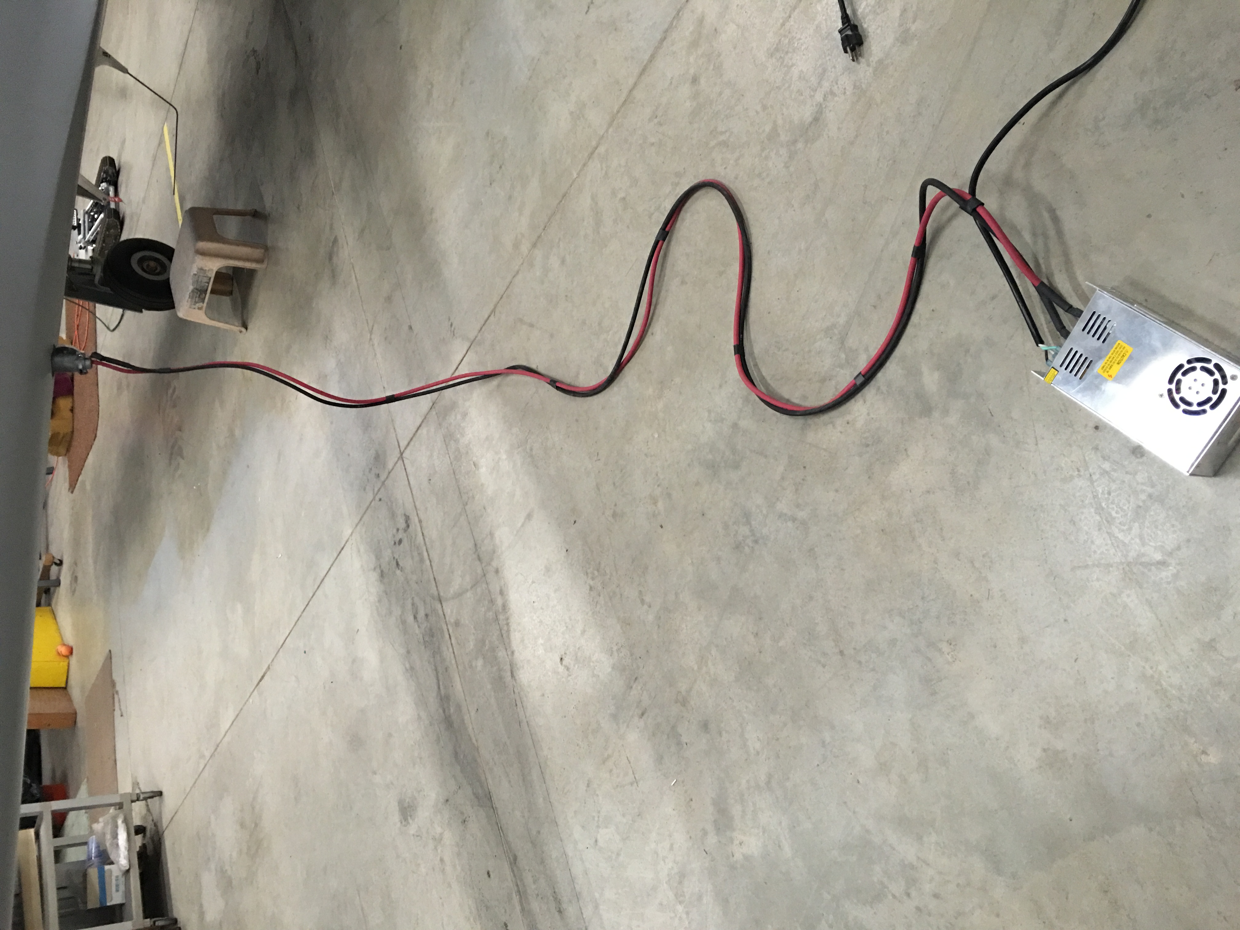

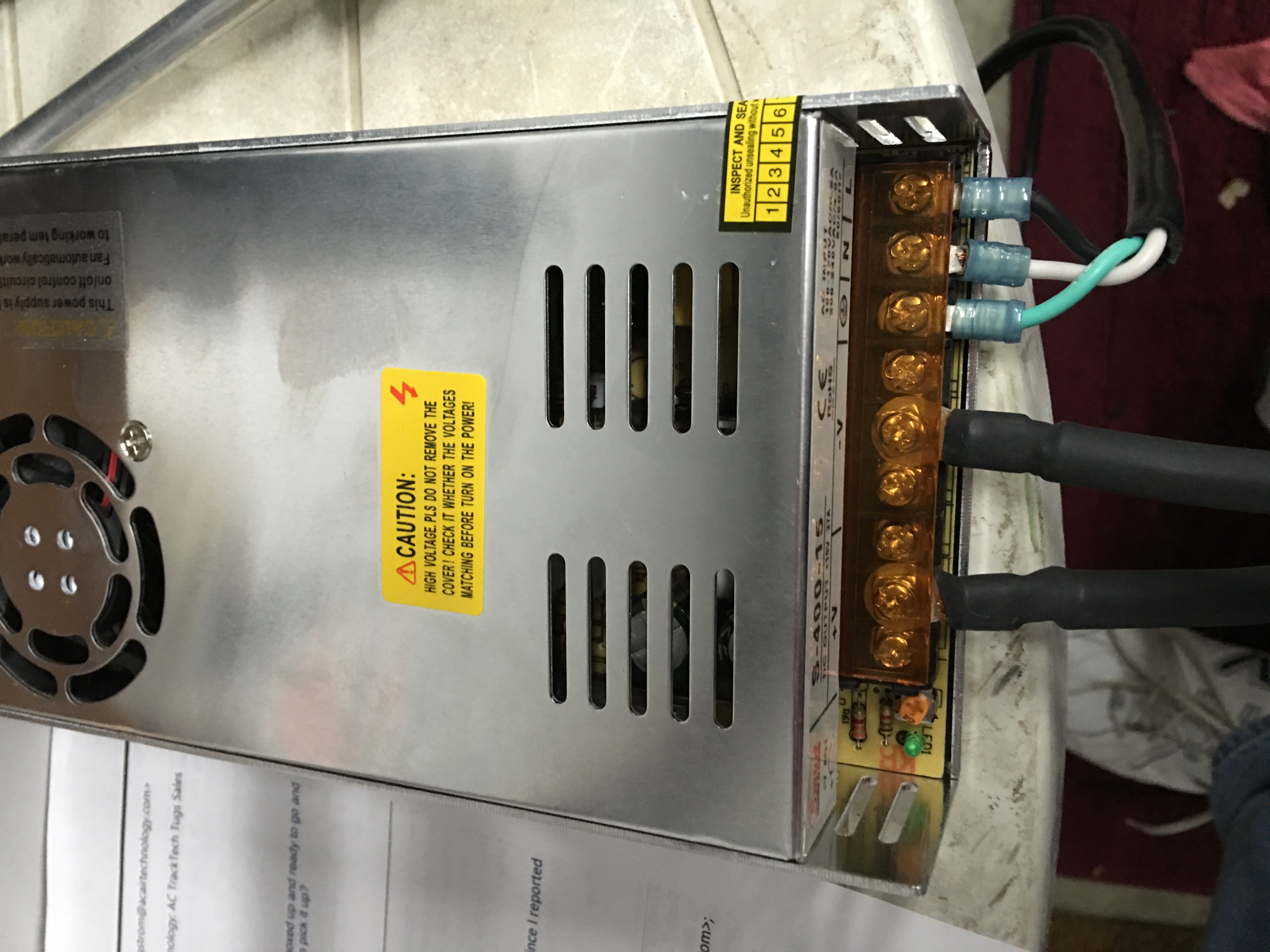

jskiba(at)icosa.net
PostPosted: Mon Jan 25, 2016 12:36 pm    Post subject: Ground power supplies DIY Reply with quote
Just wanted to follow up with all that I ordered one of the suggested power supplies and turned it down to 14v and it works GREAT !! Thanks to all
I have also enclosed so pics
Thanks again Jeff
