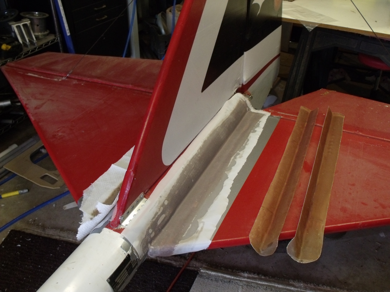

I didn't make any photos of the duct tape seals but I did of the seals made
from fiberglass. I made them right on the aircraft using duct tape as a
release agent, a standard Burt Rutan method. On the "X", since the
horizontal stabilizer is straight down the boom tube, I made two seals for
each side then bonded them together. If I had it to do again, I'd tape off
the underside, too, shoot some house sealing foam into the gap then sand
the top to shape so I could get a better form around the forward stab
mounting hinge. Another thought I've had is that I could probably have made
good seals that would have allowed easy folding with foam tape like that
used for sealing a camper shell to a pick up bed.

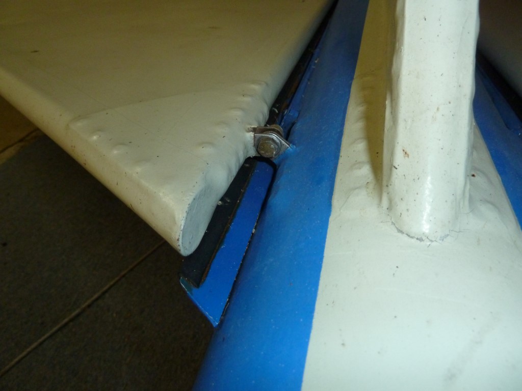

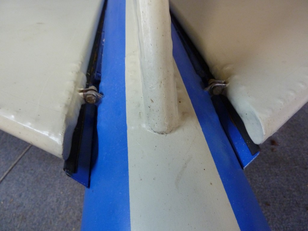

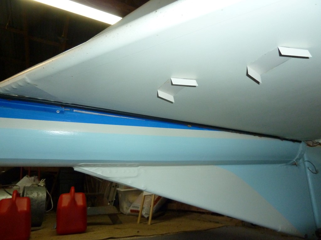

Good topic. I noticed a substantial difference in elevator effectiveness when I gap sealed the elevator on my MKIIIC to the horizontal stab (Not likely that I could gap seal it to the vertical stab...) and also added vortex generators to the underside of the horizontal stab at the 10% cord line of the stab and elevator combined cord line.
Please post pictures of your results, and be sure to not resize them; we got to keep Herb happy and lazy! <grin>

I believe what happens is that the air leaking through the slot between the horizontal stabilizer and the boom tube causes the flow to go more vertically over the rudder rather than horizontally. I base this on the results of tuft testing I did on the Mk III's rear fuselage segment as seen in the video I shot of the tests:
https://www.youtube.com/watch?v=IG796iiymYw
I attached photos of the gap seals to the original post but just in case...... The photo shows the second set of seals with their peel ply covering with the first set of seals all trimmed up and ready to bond to the second set when they are cured and trimmed. This style of construction was only possible because the "plane from hell" had the horizontal stabilizer set on the center line of the tube.
Rick

Rick- How do you fold it? It looks to be a rigid assembly.

Couldn't the seals be attached to the boom tube under the horizontal stab. so it could be folded. Also if properly braced it might take the place of the upper wire bracing.

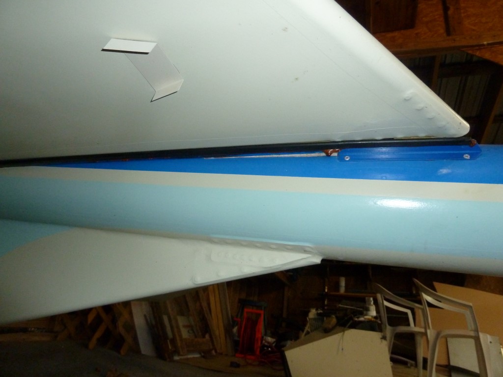

Many years ago I made some gaps seals to go between the horizontal stab and the tube of my MKIII. The trick is having something that gets real close to the stab, but still allows the horizontal tail to fold up. Here is what I did: go to Lowes and get some 1/2" by 1/2" by 1/16" aluminum angle. Along the side that you will have next to the stab, you will glue some rubber u-channel from Aircraft Spruce, part # 05-02200 ( https://www.aircraftspruce.com/catalog/appages/uchannel.php?clickkey=429408 ) The stab folds up and down while just barely touching the rubber u-channel.
In front of the front hinge, the space is too wide, and you will need to use 3/4" by 3/4" by 1/16" aluminum angle to fill up the gap. Also it was easier to get everything to line up by having the piece in front of the hinge opposite - or upside down - as it attached to the fuselage compared to the section behind the hinge because the stab is not attached parallel to the tube, the front of the stab is higher. This causes the gap to be bigger in front which means you have to spacer out the front of the 1/2" angle away from the fuselage a bit to keep it up against the stab. Which means you have to bend the aluminum angle a bit to keep it at a constant angle against the stab, and you need to fill that space between the tube and the angle with balsa wood or similar to fill the gap and make it look right.
Hopefully the pictures will make sense.
One other thing - if you put the u-channel on last, don't use Gorilla glue. It sticks great, but it also bubbles out underneath and looks terrible. As you can see.
 Filesize:  120.9 KB
 Viewed:  20572 Time(s)
 Filesize:  123.53 KB
 Filesize:  118.45 KB
 Filesize:  123.65 KB
