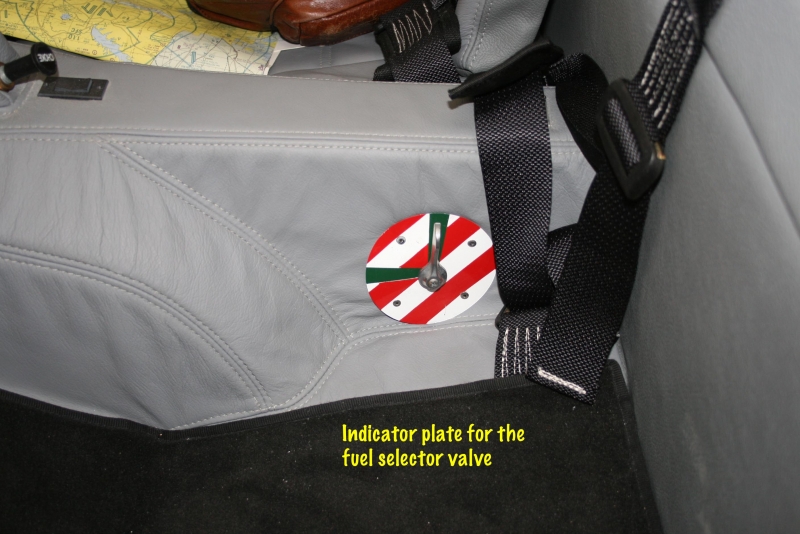

Hi
Happy New Year
I have been flying for some time (read: some years …) without a placard on my fuel valve saying “Main”, “Reserve” … Have anyone a nice design for a placard I can “borrow” ?
It is the original fuel valve.
Gert Dalgaard
OY-GDS / Mono / 914 / Woodcomp / 600+ hrs

Gert, Why not keep it simple and just have 'OFF', 'MAIN' & 'RESERVE'?

Yes, why not?I was thinking, that there guaranteed is someone in Europa Community, who have spend a weekend on designing a placard in “Word” … Smile

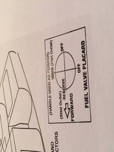

Maybe this will help:
[img]cid:0226EB0C-7CE9-4A66-A5A2-B63031F920FE[/img]
