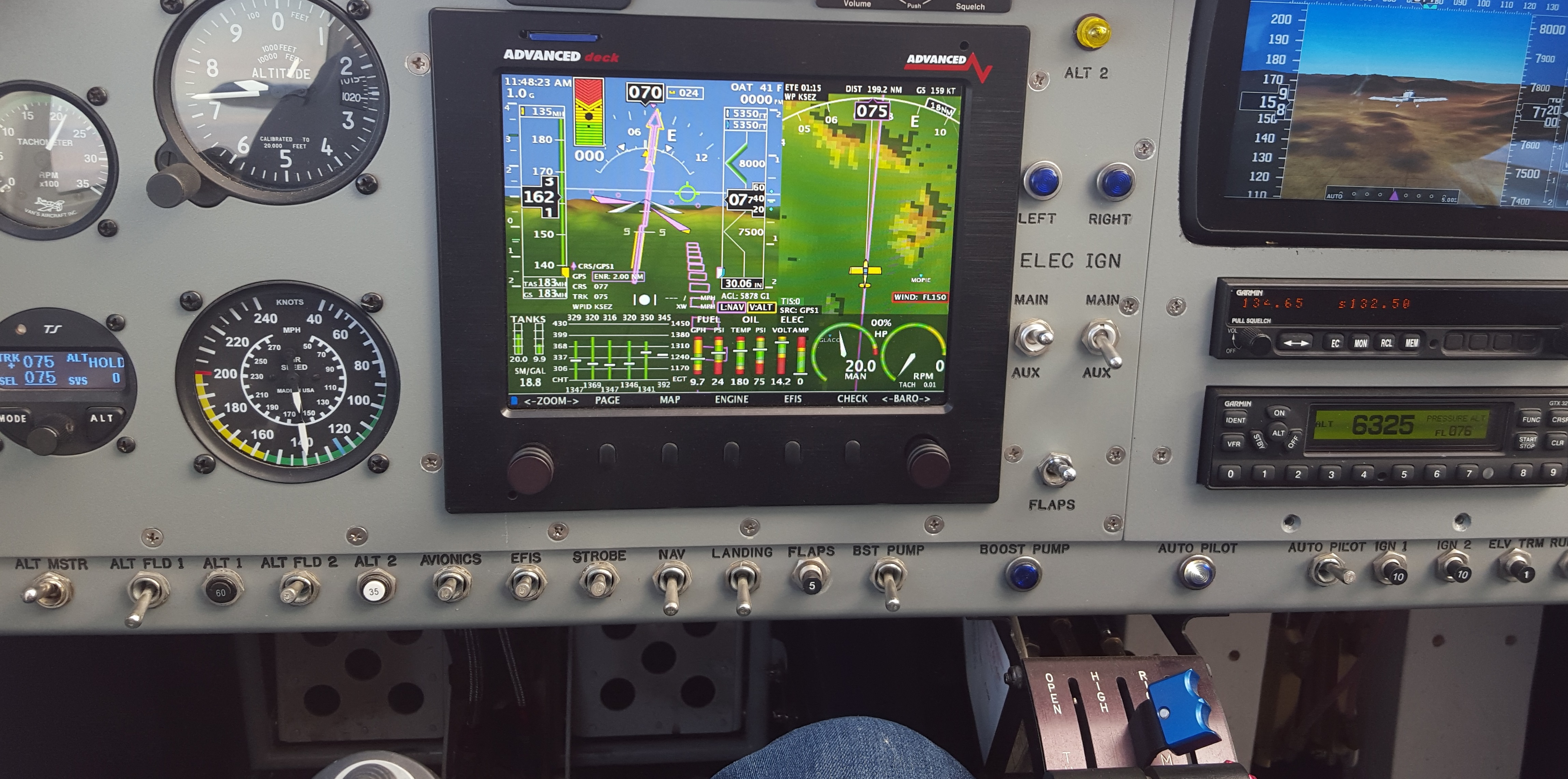

A couple of pics to share. First is a shot take Christmas eve by a friend while I was flying his family members.... he just happened to catch the 10 in the right spot.
This was taken on the way back to Texas from California, with a 2 day stay in Sedona, just after Thanksgiving. Shows 1/2 throttle, 20" at 7,700', rpm 2,100, in reflex, not much wind. RPM on left, could never get AFS screen to received rpm from electronic ignition. Using backup alternator as an exercise, that's why the amps don't show
