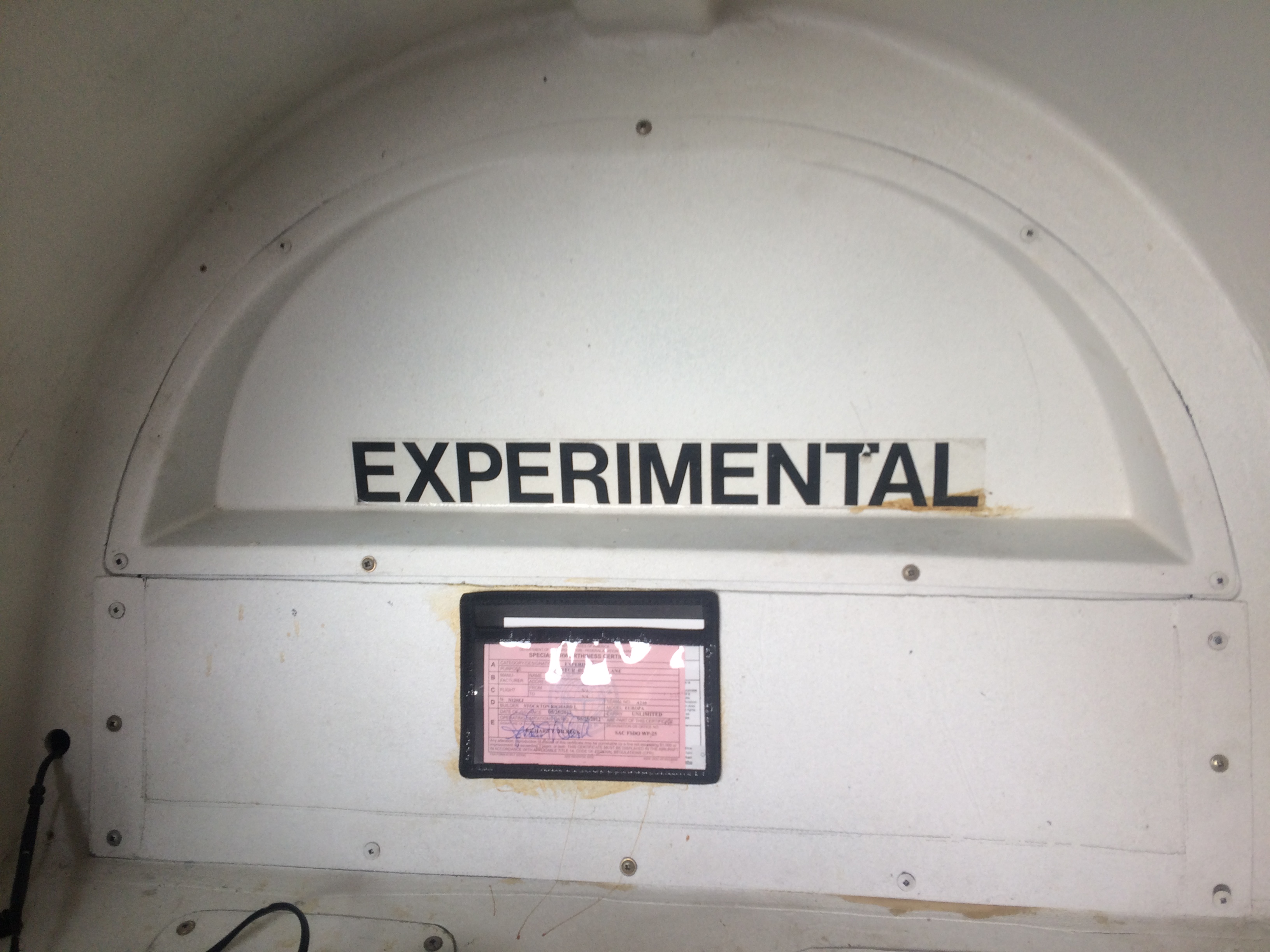

PostPosted: Thu Dec 31, 2015 8:30 am    Post subject: Re: Fuselage luggage bay Reply with quote
Sorry it has taken so long to get back to you, but I had to go to the hangar yesterday to take a picture. I thought I had some pictures when I did the work. I think I did the cut during the first condition inspection. I found I just could not get into the back to check things out.
I made the cut straight down from the "D" (F08) spacer or hat rack. If you look closely at the picture you can see the cut between the "D" spacer and the bottom panel Then straight across the baggage then up to the "D" spacer. I made the bottom cut 1 inch above the curve section on the bottom. I then re-enforce the panel with three layers of 2" fiber-glass tape with 1 inch on the outside of the cut. I laid the panel flat and let the resin dry then installed nutplates along the backside and the bottom of the cut.
I later found the bottom flange cracked out because of my weight during the inspection. I had to go back and re-enforce this section. I then had to use a 1 inch pad or board to keep from lying on the flange.
If I did the work again I'd cut the curve so it would be flat and the screws and nut plates would be on the bottom of the floor and nothing would be sticking up.

PostPosted: Thu Dec 31, 2015 9:00 am    Post subject: Fuselage luggage bay "D" panel Reply with quote
That looks like it makes life much easier.  I see you're flying so obviously it hasn't affected the structure,
Is there any rule when you substitute a panel for a bonded structure in terms of fasteners per distance.
I still haven't installed the bulkhead and so have the opportunity to modify it on the bench as it were.  I suppose that I could simply make a single panel incorporan the D panel instead of the two that you have.
Thanks thats helpful

> --> Europa-List message posted by: "gleinberger" <gleinberger(at)millersville.edu (gleinberger(at)millersville.edu)>
> First, I am glad to see there are other properly sized people flying the Europa. At 255 lbs.  and 6 foot, I believe the Europa was designed by a team of elfs, dwarfs and hobbits.
> Getting in the back is a real pain - and don't forget the tail support - the feeling of the tail going to the floor as you are sliding through the infamous D hole is exciting.
> Use a wide board that fits over the tank and then crawl back on it (Bud Yearly hint number 756.)
