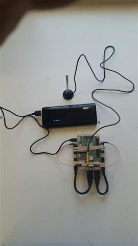

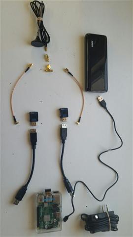

Well, here is the finished product except for a custom case to put it all in. So far I'm just using the plastic case the Pi came with. I'm trying it out using a splitter and 1 antenna. The big black rectangular object is a battery so it will be portable. The 4 USB hubs are very close together and the radios are too large to fit in them side-by-side so you will need the short M/F USB cables to get them away from the Pi. This was by far one of the simplest projects I've ever done and now I'm ordering a GPS to add since my ipad doesn't have one built in.
Thanks for all the help from the list. You are worth your weight in gold.
Albert Gardner
RV-10 N991RV
Yuma, AZ
PS: I also attached the shopping list that I was given to get me started.
