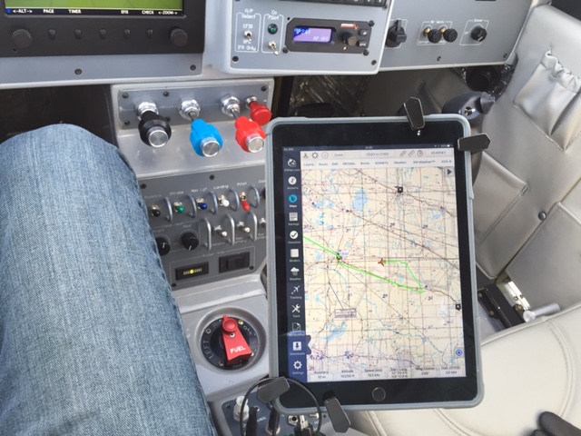

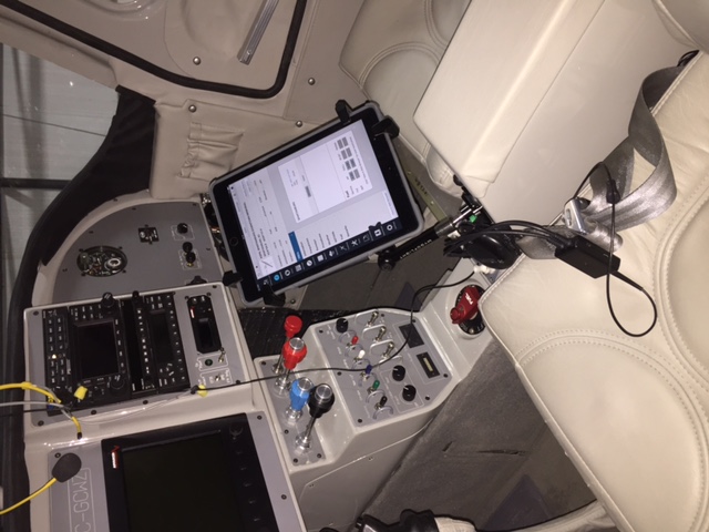

I do have a boxing day suggestion for those who haven't depleted all their free cash buying gifts for family. My wife Joan especially liked the can of 3M spray adhesive I got her. I plan to borrow it for my foot-well carpets!
Anyway, at KOSH I picked up a MyGoFlight.com IPAD mount. Attached are a couple of pix. It has a single point of adjustment that locks the three joints in one go. I mounted it on my center console but it will work just as easily on the center tunnel. The version I have has a quick disconnect so the arm and IPAD mount can be completely removed from the consol attach point.
I find that offset to the right leaves the controls etc clear and provides very confrtable access to the IPAD with my right hand.
In this configuration, I tried sitting in the co-pilot's set and found that it doesn't interfer with the right side at all.
YMMV
Cheers and have a great New Year
Les

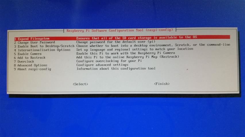

Well, this whole Stratux thing get me going so I bought the Pi and the 2
radios plus cables on Amazon. Put them together, very easy-just plug
together- and then downloaded the software. Got the disk image file for the
micro SD card (stratux-v0.5b2-e6ad9aa830-12212015) from the zip file
download. Used Win32DiskImager to copy it to the SD card then put the SD
card in my Raspberry Pi computer and fired it up.
I was expecting it to be configured as an ADS-B receiver already to receive
broadcasts and connect to my ipad with Foreflight but the monitor connected
to the Raspberry Pi shows a screen that asks for basic configuration
information. Some of the item seem straightforward but don't know what to
answer for others. (Screenshot attached)
Has anyone already gone through the setup? Could use some help at this
point.

PostPosted: Sun Dec 27, 2015 7:58 am    Post subject: Merry Christmas - Boxing day suggestion Reply with quote
You could do the expand file system to maximize the use of the SD card, but everything here is optional.
The config for the ads-b is through a web browser but it should already be setup with some usable defaults "out of the box".
-Dj

PostPosted: Sun Dec 27, 2015 11:25 am    Post subject: Merry Christmas - Boxing day suggestion Reply with quote
I should clarify that this display was on a monitor attached directly to
the Raspberry Pi computer itself not on my desktop computer. Am I to
understand that I can do configuration from my desktop by connecting to the
Pi by the 162.198.10.1 or whatever?
Albert

PostPosted: Sun Dec 27, 2015 12:00 pm    Post subject: Merry Christmas - Boxing day suggestion Reply with quote
Setup wifi to "stratux' on iPad
Ip to 192.168.10.1
This will show the connection and towers etc. with r2 you can shut down from here as well
Once you have the stratux as wifi connection I think foreflight will pickup - sorry don't use foreflight so can't tell you were to setup the ads-b but shouldn't be hard to find , maybe "settings "?
FltplanGO had Ads b option on map
[quote] On Dec 27, 2015, at 11:29 AM, Albert <ibspud(at)roadrunner.com> wrote:
Albert
deej(at)deej.net
PostPosted: Sun Dec 27, 2015 2:53 pm    Post subject: Merry Christmas - Boxing day suggestion Reply with quote
On Dec 27, 2015, at 2:21 PM, Albert <ibspud(at)roadrunner.com> wrote:
Am I to
Join your iPad to the Stratux wireless network, then use the web browser on the iPad to connect to 192.168.10.1
This will allow you to change the config of the Stratux software, if needed.
-Dj

This was interesting. While the monitor connected to the Raspberry Pi still
showed the configuration message,
I joined the Stratux network with my ipad. Then I started foreflight just to
see what it looked like and I had the freeflight message with 0 towers. I
carried the whole setup outside and saw some traffic symbols on the display.
Never picked up any towers but I already expected you couldn't while on the
ground. So I guess you don't have to really do anything after you load the
SD card. Great. Now I need to find out how to attach a GPS unit to my
Stratux box.
Thanks for the help.
Albert
