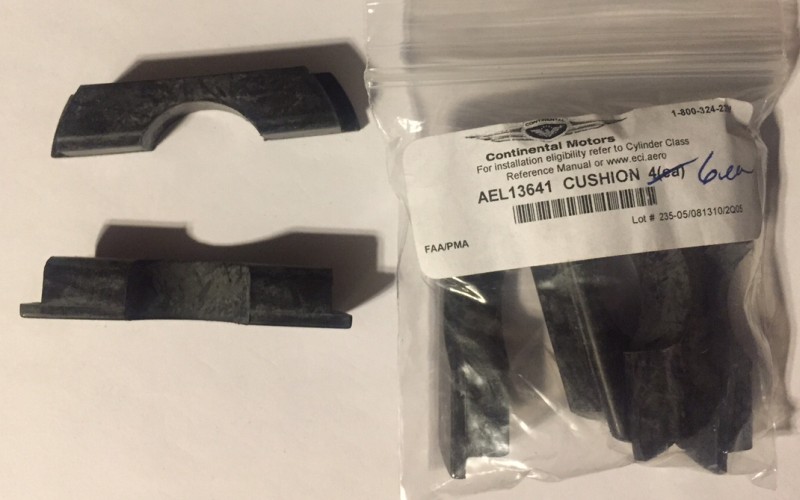

So on the topic of these Mag drive bushings...
I ordered 3 sets of them to keep on hand. They were cheap.
But, I think there is an issue with my order.
I am pretty sure my old bushings did NOT have the tangs out the side.
The old bushings were the LW13641 type then, because the new
drive gear is p/n LW-13899 and the new cushions are
p/n 68H22624, and if you read SI 1299B, it shows a picture
of the new ones having tangs on them.
Attached is a photo of what I received. Yes, mine were not
"lycoming" branded, but sold by Continental (previously ECI),
and are aftermarket. But they came with the tangs. So I can
only assume that they are shipping the incorrect (new) part
under the old part number. Even the baggie they came in has
the old p/n.
Does this sound correct to any of you that are in the know?
Tim
On 12/7/2015 9:52 AM, David Saylor wrote:
I poked around and found Lyc Service Instruction 1299B. It has p/ns,
pictures, applicability, yada yada. I'm not sure if they work on all
Lycomings but the SI gives SN ranges. --D
