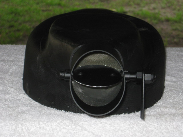

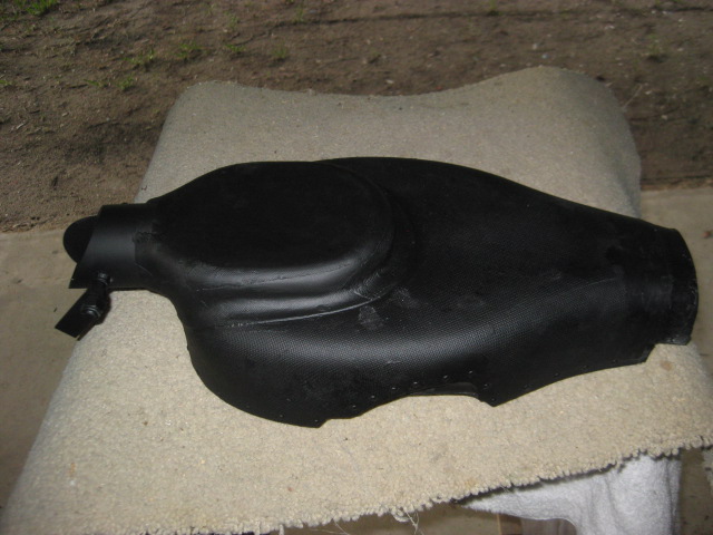

I would guess if you never over-primed you'd not need the drain.  However I've seen pictures on this list of misshaped filters that I believe are caused by the rubber sitting in avgas for an extended period.  I thought about the alt air valve and just didn't like it a whole lot.  I just don't like an engine control that I can't return to normal until I land and shut down.  I don't think snow, heavy rain or anything of the sort would cause the filter to seal up, but a well-placed bird could block the inlet so I didn't want to just do away with the alt air.
So, here's what I did .....
[img]cid:part1.06070100.03010500(at)cfl.rr.com[/img]
[img]cid:part2.06010308.00030902(at)cfl.rr.com[/img]

My concern about relying on the Alt Air door as a drain revolves around its relative position to the exhaust.   Dripping fuel would turn to mist in the lower cowl air flow and potentially ignite.
The advantage to the drain (on the back of the box) is that it can be plumbed to an area where the exhaust pipes aren't a factor. The ram air would push the fuel to the back of the box, then it goes out the drain and down the plumbing.
Also, FWIW, my alt air door opens and closes and was built per plans. I haven't operated it on a running engine yet so it's possible that could change with negative pressure in the box; but I can open and close the door using the control cable without any issues.

Think about unfiltered air going around your plate that does not make a complete seal.
Not so much in flight, but on ground.

If I understand his pictures properly, I believe the butterfly valve is
to keep unfiltered air out unless alt air is needed. One could have the
valve open for startup and shutdown to allow draining when there is
potential for raw fuel.

The ram air fills the cavity outside the filter then turns inward and goes through the filter from all sides. Fuel inside the filter would stay there and evaporate and be ingested into the engine intake. The drain is so fuel from over boosting can drain out when the engine is not running. Am I missing something here? Fuel can't even get into the airbox when the engine is running, can it?

Not a bad observation.  However, on the ground, with the engine running ..... I think there's enough air flowing down and out to keep any dust from being sucked in.  There are really small gaps where the bushings are, but the plate is an ellipse and seals really well since it's at an angle in the tube.  The hole in the original FAB (per plans) has screen over it to keep out FOD in event the screws (or lizards, mud daubers ....) holding the plate to the shaft come loose.
You'd be amazed at what some certified aircraft have for alternate air ......

Nope .... no fuel can enter the FAB when the engine is running. I suspect that the mis-shaped filters I saw were due to avgas entering the FAB due to overpriming .... and once in the belly of the FAB it won't get sucked up into the engine when it starts, so it's there until it evaporates.  Repeated doses of avgas causes the rubber on the filter to expand.   I may be wrong ..... Wink

The air. filter do not expand they shrink. I'm talking about dust and cr--p that will be sucked in since its on the lowest side of sucking pressure, not required to go through air filter. You don't have a positive seal with your plate. Only you will know when you start getting oil analysis and see what shows up.
<alt air mod 01.JPG>
<alt air mod 02.JPG>
On 12/31/2015 6:44 PM, Dan Charrois wrote:

Having thought about the comments about dirt ingestion through my modified FAB ..... I'll get a motorcycle filter to fit over the tube ..... thanks for the 'heads up'.
