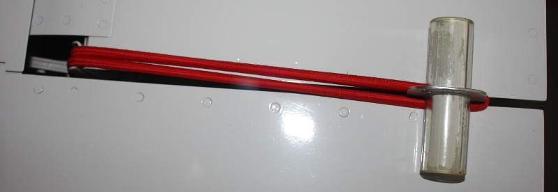

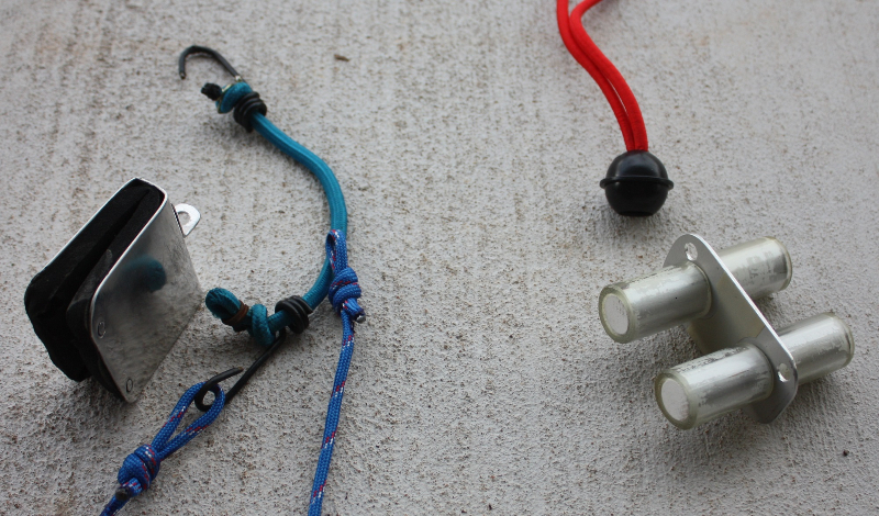

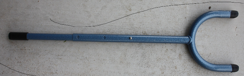

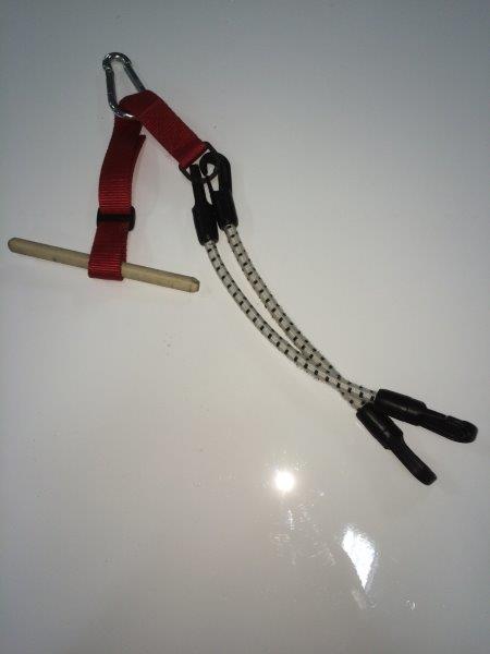

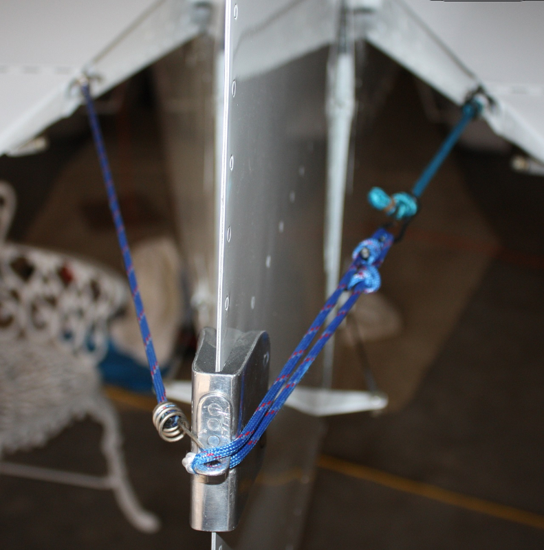

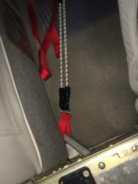

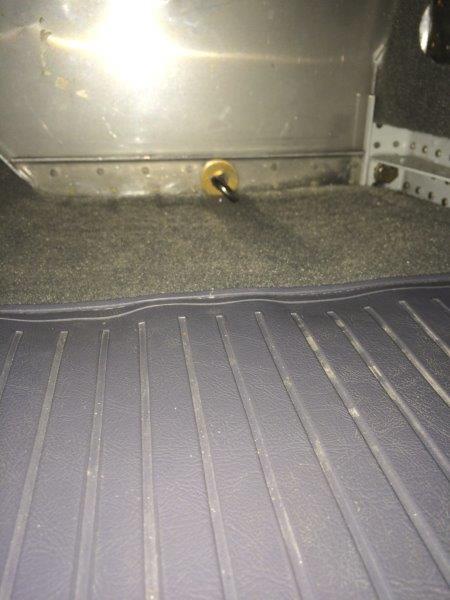

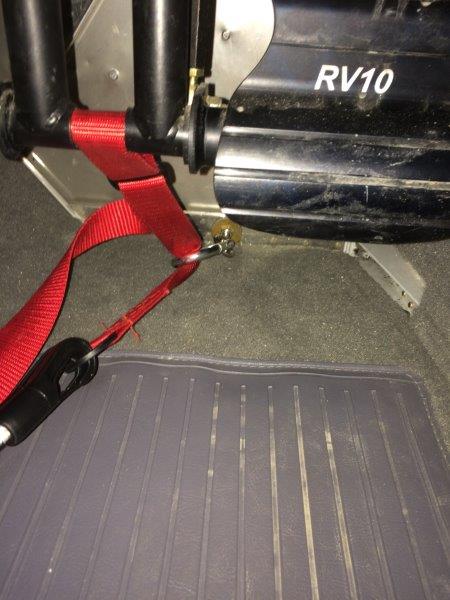

Hi
Since I have Paul Grimstad rudder pedals I wasn't sure if the "standard" options would work for me.
What I ended up doing was installing an eye bolt in an open AN3 hole in the u channel at the base of the firewall. I use that as an anchor point through which a bungee cord is used to pull both pedals forward. The end of the bungee is secured to one of the gear legs arms that is in the corner of the foot well.
I used this at KOSH and it seems to have worked quite well. I especially like that the bungee has some "give". I found one bungee was too loose but two held a nice tension.
For the elevators I just use another bungee wrapped around the seat to hold the stick back
See the pix below.
Cheers
Les

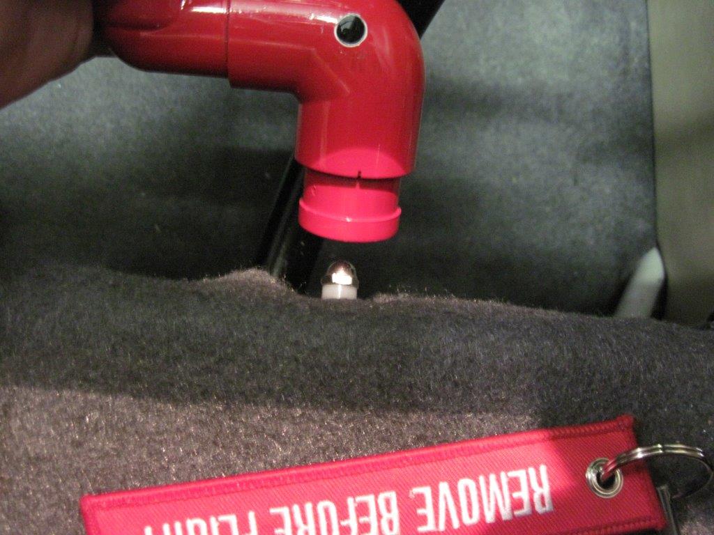

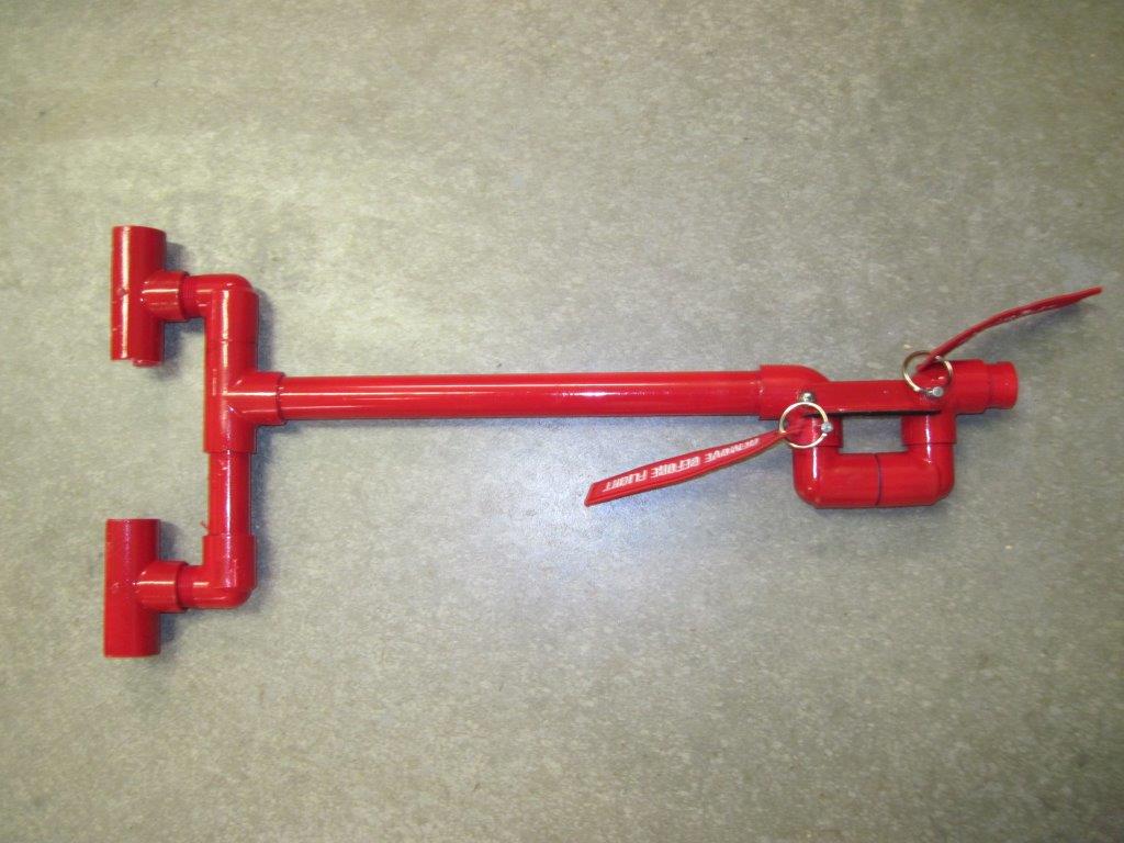

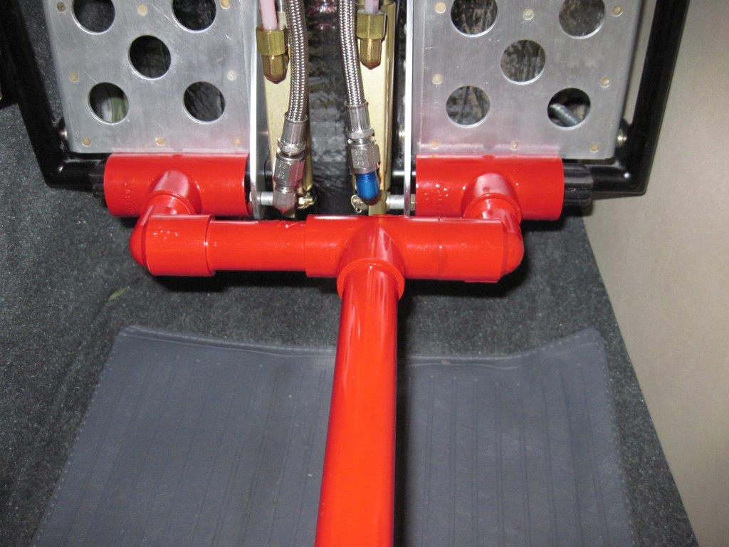

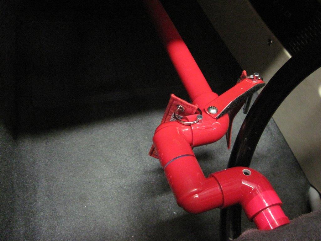

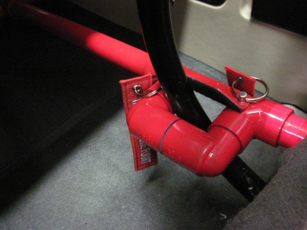

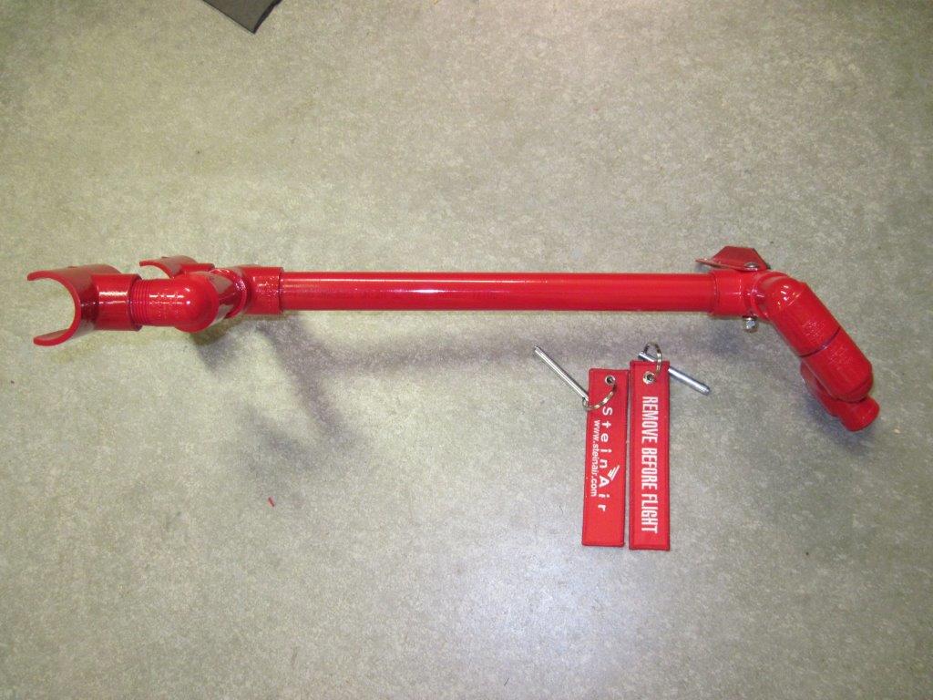

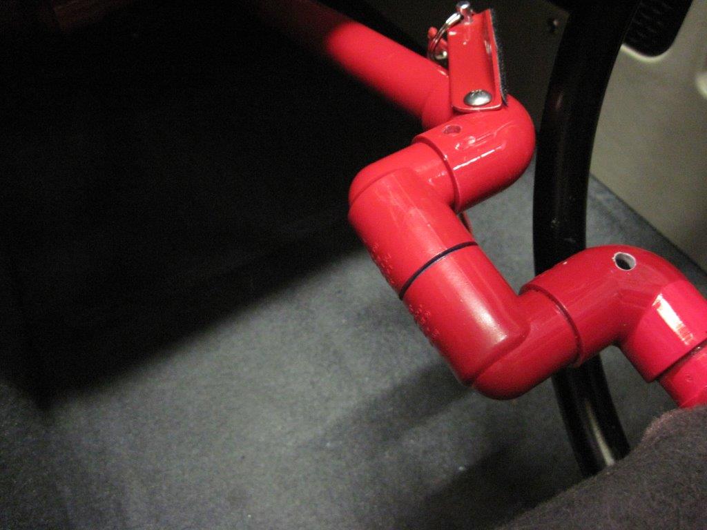

Here is my $15 solution that has worked for 3 years without fail.

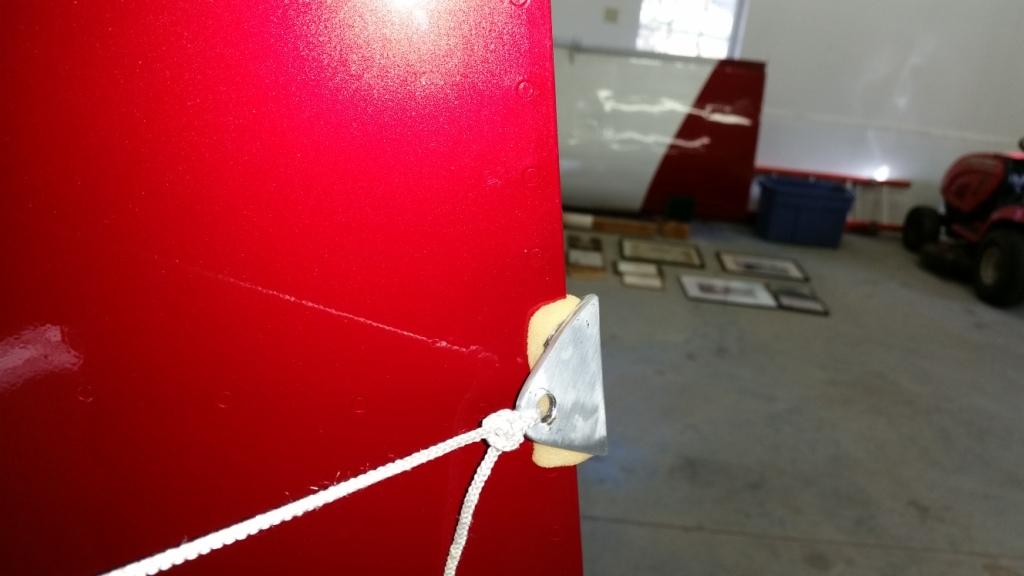

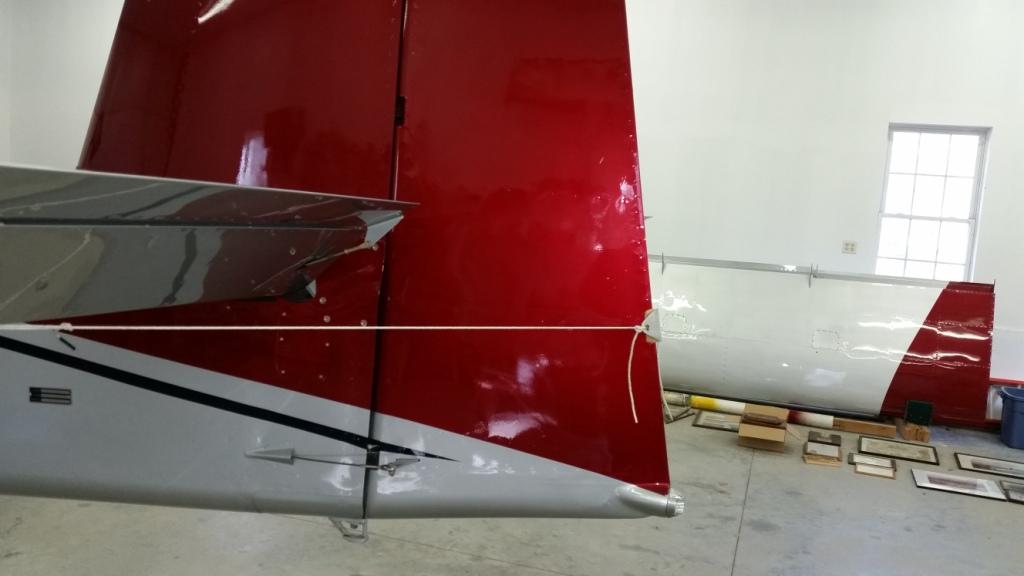

I think I've posted this before, but  here is my <$200 [url=http://www.mykitlog.com/users/display_log.php?user=MauleDriver&project=224&category=0&log 0875&row=3]Bogi-Bar solution[/url] that does double duty.
Worked for a year unmodified, then worked even better in modified form for the past year.

I think I did see one of this design (PVC) fail at OSH this year. There was
quite a thunderstorm /windstorm that came through Friday night before the
show. I think the PVC snapped on the long part.

I have a destroyed rudder in my shop from a failed pvc gust lock. For short stops in non-stormy conditions, they may be fine, but please please please don't trust them over a weekend or any time there are going to be relatively high winds.

One of the first PVC units that I fabricated used a much smaller diameter PVC for the long pipe. I did not like the strength that it exhibited, so I used this larger dia. pipe.
I may do some destructive testing on an older prototype to see how much force it may take to snap it.

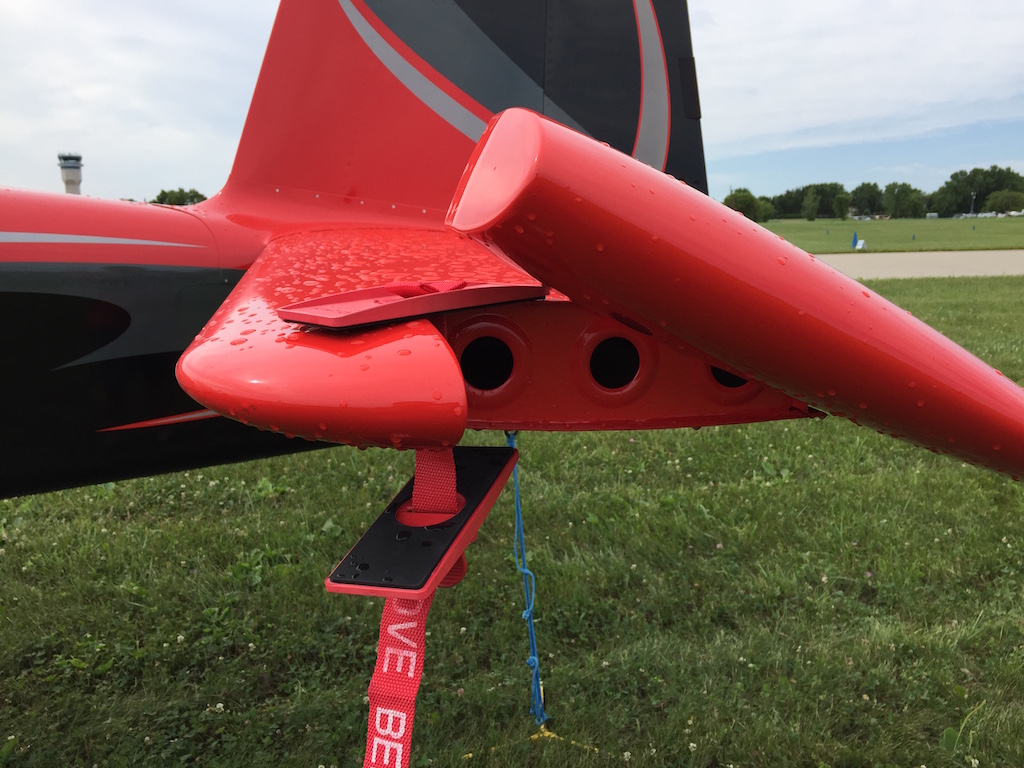

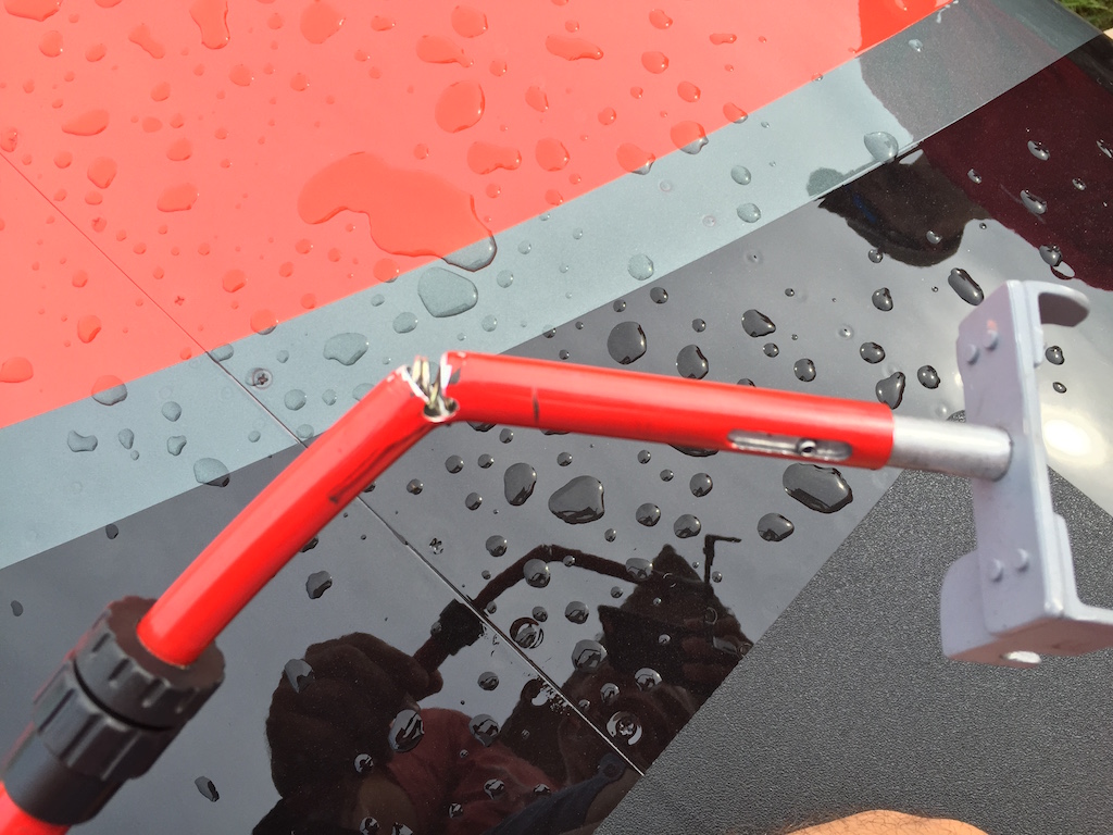

My modified (to fit my pedals) Gust Off gust lock broke in half in that storm. As a backup I had a pair of AirGizmos control locks, the one on the elevator came off. It had the older style cam, and they replaced it at the show to the new one, no charge.
Luckily the plane didn't get damaged at all.
Base velocity on RadarScope was showing 50-60 mph winds.

Pic1: My standard for short stays
Pic2: Elevator bracket for long stays/windy conditions.
Pic3: Rudder, long stays/windy conditions
Pic4: Parts required for long stays/windy conditions
Pros:
Cost = almost nothing
Reliability = 100%
Weight = almost nothing
Space required = almost nothing
Cons:
You have to make them
Don McDonald
800 hours and lovin' almost every minute.
Lenny
-Chris Lucas

I've seen various examples of failed rudder locks that used the rudder horns
and/or rudder cables. The common failure seemed to be not considering the
rudder's large leverage arm when applying force opposite of normal
operations (e.g. wind gusts). I ended up with this simple but effective
solution that takes advantage of this lever arm.
The line loops around the middle elevator hinge (make sure you use a Bowline
knot for this for easy removal). Once the line is in place I lock the
elevators up with the pilot seat belt - and then attach the padded angle on
the trailing edge of the rudder.
This has worked well for two airplanes over 13 years.
Carl
