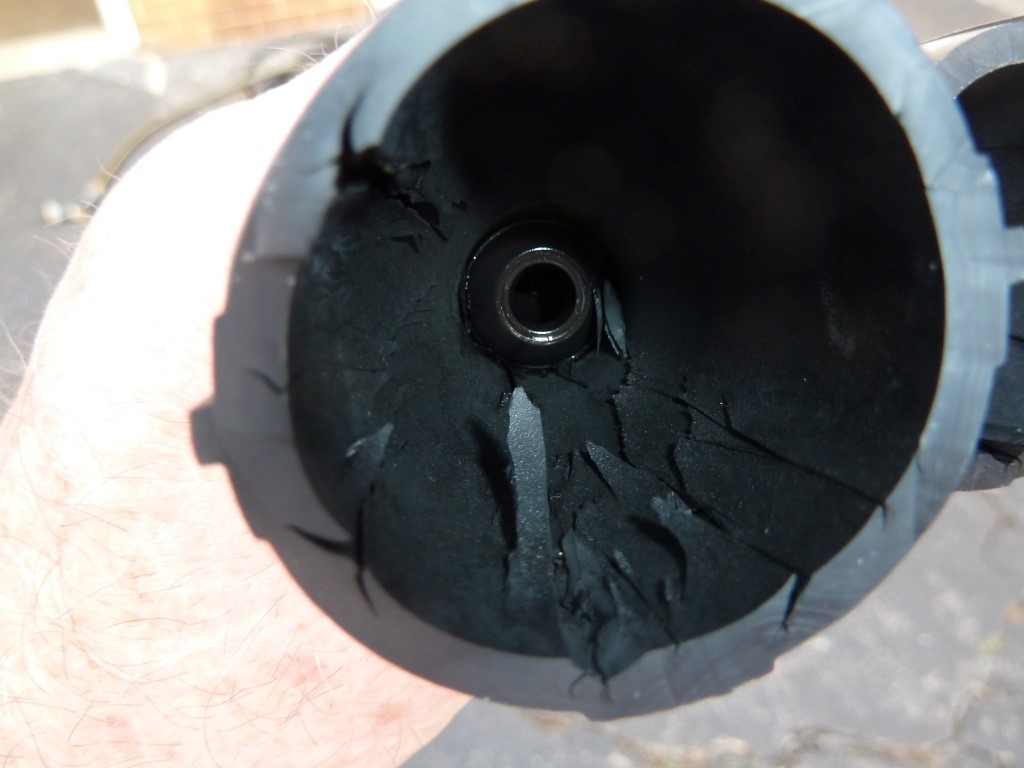

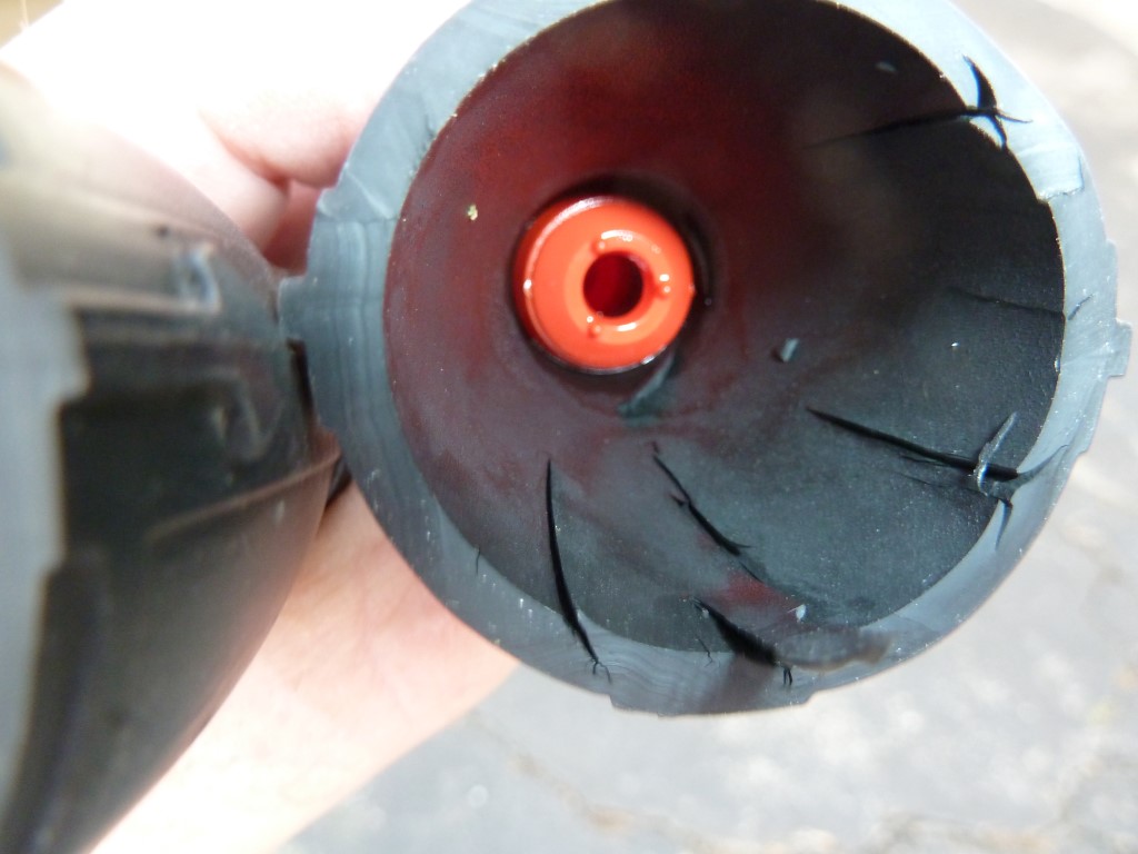

Tried to start the FSII last week, the priming system was not priming, you can get an idea of how it is plumbed on this page: http://oh2fly.net/oldpoops/Fuel_tanks_storage.html
Primer bulb was not working, put in a new one and cut the old one in half with an X-acto knife. Very interesting: the inside was coming apart in strange ways. Note a couple little fragments of rubber right next to the ends where the check valves are. They are not a result of cutting the bulb apart, they were there and got discovered. Guaranteed to make the bulb not work right.
Don't remember how old this bulb is, but they obviously have a fairly short service life, probably ought to replace at annual.
