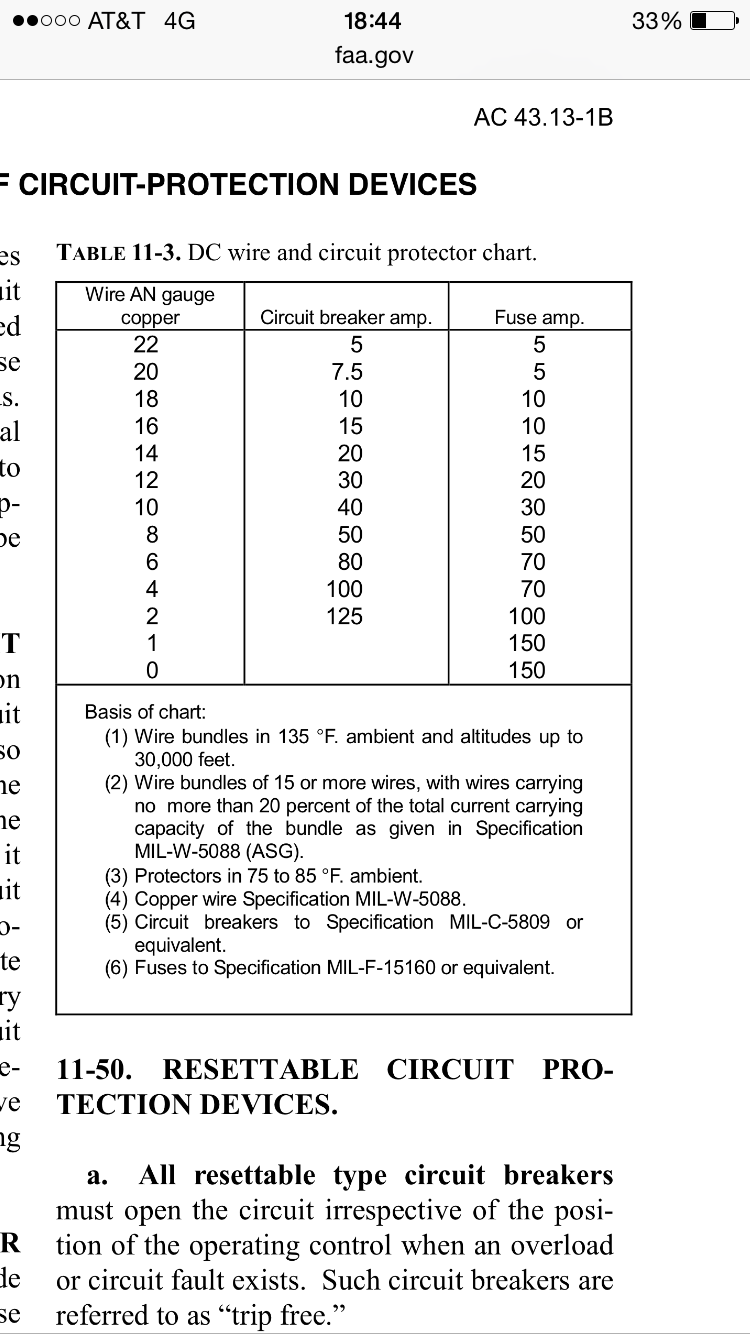

Hangar talk with a neighbor. He is designing a circuit using 4awg wire for his alternator. He asked me if he could use 2 - 50A circuit breakers wired in Parallel for this purpose instead of a single 100A breaker. Chapter 11 in AC 43 says to use a 100A breaker or a 70A fuse for 4AWG wire. I suggested the use of a 70A ANL fuse, but wasn’t sure what the answer is to the CB question he had.
Any insight?

No. (To using 2 breakers in parallel.)
And that's a weird recommendation, too, unless the fuse mentioned is a
special long-time-constant 'slow blow' type fuse. A breaker would take a
lot longer to trip than a standard fuse of the same value; going 30A
higher with the breaker *and* having slower response sounds really strange.
Buying 2 50 A a/c breakers (or even one 100 A breaker) would just kill
my (wallet's) soul. A fuse-able link would be lighter, take no panel
space, a *lot* cheaper, and if soldered in place, a *lot* more reliable
than a breaker (no joints to corrode or contacts to fail). If it's
properly sized, it shouldn't need attention for the life of the a/c,
unlike a CB.

The ANL fuse suggestion came from Bob's Z diagrams (note 10)

ANL would obviously be fine, but I was assuming that AC43 wouldn't be
recommending ANL fuses. Even with ANL, it's still weird that they would
equate a 100A breaker to a 70A fuse.

I thought it was strange too. It's table 11-3 on page 11-15 in chapter 11 of AC 43.13.1B

Keep in mind that ANL are really current limiters (as opposed to fuses) which have a different (slower acting) current curve than a regular fuse and/or breaker (faster acting). They can hold a little over their rated value for a fairly long time (like minutes). Google "ANL current curve" for details ...

Jeff is right: in this situation the ANL fuse is matched to the alternator output, not to the wire size

Circuit breakers should not be connected in parallel. An ANL fuse is fine. Circuit protection should be located near the source of power. One might think that the alternator is the source of power. But in this case, the battery and wires are what need protection in case the alternator or its "B" lead shorts out. A disadvantage of using a circuit breaker for this application is that it would be located inside of the cockpit and fed with a hot unprotected wire. An ANL fuse can be located near the contactors on the engine side of the firewall, thus eliminating at least one heavy wire from running into the cockpit. Is 4 AWG wire really needed? Maybe 6 AWG or even 8 AWG could be used, depending on the expected load. Modern avionics and LED lights use less current than older equipment.

You are right Charlie. I should not have suggested a smaller wire size without knowing the ampacity of the alternator.

At 06:02 PM 12/7/2015, you wrote:
--> AeroElectric-List message posted by: Justin Jones <jmjones2000(at)mindspring.com>
Few OEMs (if any) in the certified iron business
use circuit breakers in the alternator b-lead.
At Beech, current limiters on the firewall have
protected the b-lead for 30 or more years.
Check out the products on this webpage
http://tinyurl.com/by5qnop
These are miniature, high current fuses
and matching holders widely available through
automotive and mobile sound system dealers.
You can find all sizes along with mounting
bases on ebay.
http://tinyurl.com/jn9k9nu
One caveat . . . AVOID the fuse holders
that grip the fat-wires with mash-screws.
You want a holder with captive, male studs
which are used to place the fuse-tab into
intimate contact with the ring-terminal on
the end of your b-lead wiring.
A holder like this one
http://tinyurl.com/54fk
can be 'modified' to a satisfactory aviation
fuse holder by discarding the mash-screws
and dropping your ring terminals over the
fuse attach screws.
Consider making your own fuse holder . . .
A block carved from phenolic, delrin, micarta
or other high temp, machinable plastic.
http://tinyurl.com/jdatd3e
These parts combined with some 10-32 stainless
steel screws, nuts and washers from a hardware
store will produce a robust alternative
to purchased/modified fuse holders.
Pick a MIDI fuse rating at or just above
the alternator rating. If the guy wants to
use a breaker, the rating should be 20-50%
LARGER than the alternator output. Finally,
DO NOT parallel breakers.

Convinced him to go with ANL fuses. Where is the best place to locate them? Close to the alternator or close to the battery?
Bob's Z diagrams show them near the battery. If protecting against a short, wouldn't the battery end of the b lead be best? Or are we simply protecting from an over amperage condition?
Justin
bases on ebay.
fuse attach screws.

On December 10, 2015 3:21:06 PM EST, Justin Jones <jmjones2000(at)mindspring.com> wrote:
Justin

Few OEMs (if any) in the certified iron business use circuit breakers in the alternator b-lead. At Beech, current limiters on the firewall have protected the b-lead for 30 or more years. Check out the products on this webpage http://tinyurl.com/by5qnop These are miniature, high current fuses and matching holders widely available through automotive and mobile sound system dealers. You can find all sizes along with mounting bases on ebay. http://tinyurl.com/jn9k9nu One caveat . . . AVOID the fuse holders that grip the fat-wires with mash-screws. You want a holder with captive, male studs which are used to place the fuse-tab into intimate contact with the ring-terminal on the end of your b-lead wiring. A holder like this one http://tinyurl.com/54fk can be 'modified' to a satisfactory aviation fuse holder by discarding the mash-screws and dropping your ring terminals over the fuse attach screws. Consider making your own fuse holder . . . A block carved from phenolic, delrin, micarta or other high temp, machinable plastic. http://tinyurl.com/jdatd3e These parts combined with some 10-32 stainless steel screws, nuts and washers from a hardware store will produce a robust alternative to purchased/modified fuse holders. Pick a MIDI fuse rating at or just above the alternator rating. If the guy wants to use a breaker, the rating should be 20-50% LARGER than the alternator output. Finally, DO NOT parallel breakers.
Battery end. Battery can melt the wire; alt cannot.
Close to the battery. An alternator is physically
incapable of burning its own b-lead . . . but the
BATTERY is good for 1000+ amps in a fault condition.
