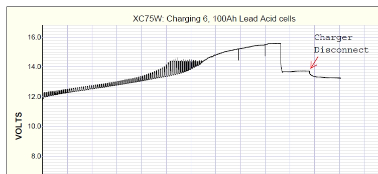

May very well be . . . the current bevy of 'smart
chargers' seem to have many and varied minds of their
own. I did some tests on a "carbon foam" SVLA battery
for Beech a few years ago. This 100AH battery would not
charge in a timely manner with any of my 'standard'
chargers. I purchased a new Schumacher charger rated
at 25A. Here's a voltage plot of the charger's output
for recovering from a deep discharge
[img]cid:7.1.0.9.0.20151210102648.07395988(at)aeroelectric.com.0[/img]
Batteries are probably the ultimate integrators of 'rough'
charging profiles but as you've noted, 'foreign' devices
in the circuit may produce unexpected behaviors.
