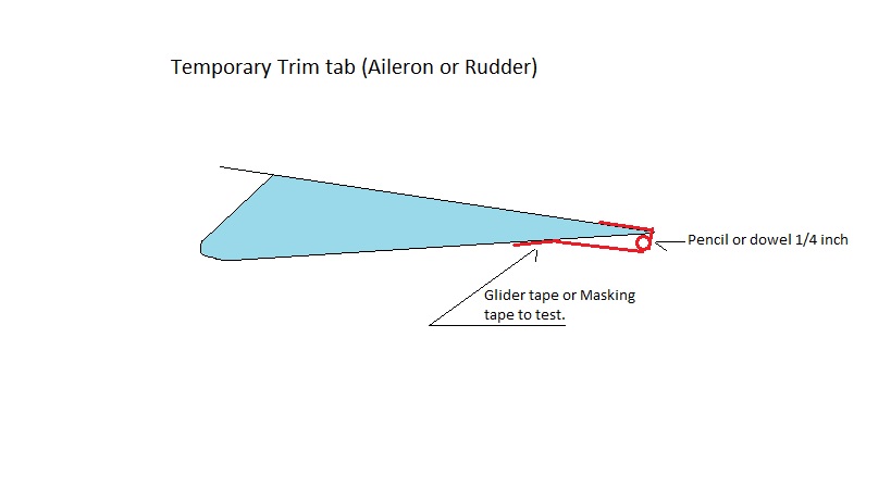

To find out how much is needed take a 1/4 x 10 inch wood pencil and some
tape and attach it to the rudder like a ramp. (See attached drawing.)
