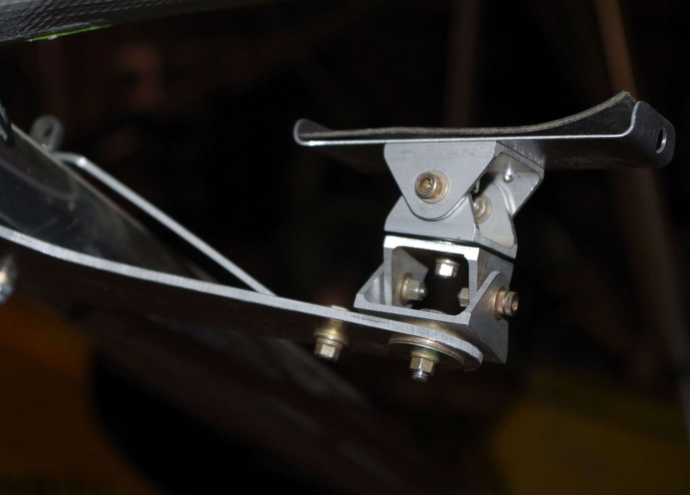

It's not for a Kolb but for my trike. Because of the changing angle of the wing I wanted adjustment in three dimensions. When I went through my strategic supplies I found two pieces of channel that nested together with just enough room for an AN960-816L washer on each side between them. Thanks to the Yard Store the total cost of the mount was about a buck.When I bolted it to the wing strut I used an eye bolt so I'd have a second safety strap in case the bolt to the camera base and the straps from the camera's strap lugs to the mount both failed.
