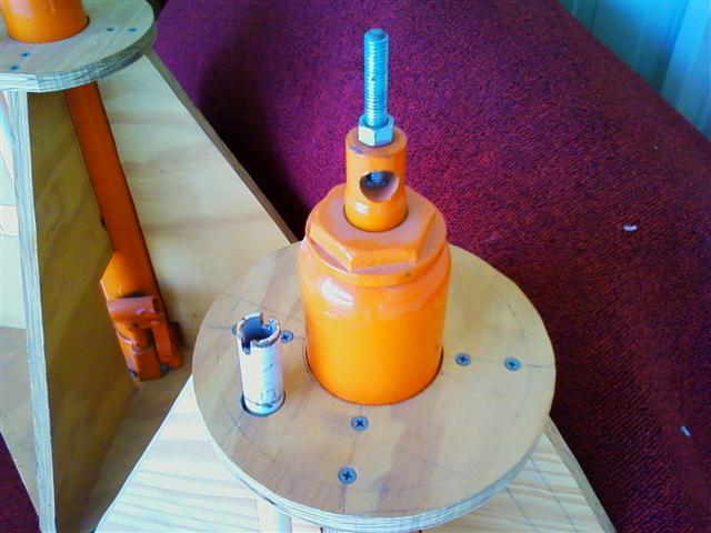

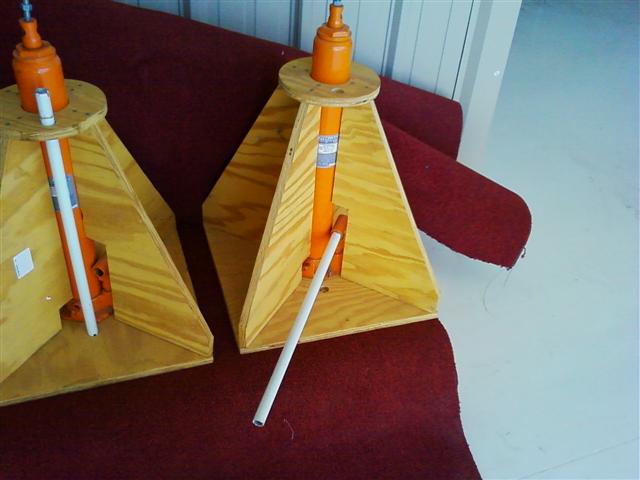

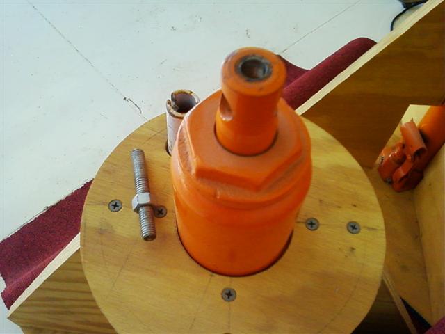

PostPosted: Sun Nov 15, 2015 5:49 am    Post subject: Wheel Servicing Reply with quote
Harbor Freight has some hi-lift bottle jacks that work well. Drilled a hole
in the top of the ram to receive a threaded rod that replaces the tie down
ring. Little plywood to make a stablizing stand and it works well.
Albert Gardner
