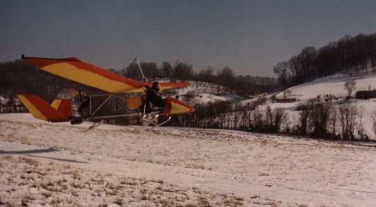

I made a set of skis out of aluminum for my Maxair Hummer back in the day, and they would stick to the snow, but I could break them loose from the snow by rocking side by side. Plastic snow boards ought to be better though. The wheels stuck through the skis, which made things a lot easier on the ground. When I first made them there were no holes for the wheels, and even though it was 30 something years ago, and I was a lot stronger than I am now, it was all I could do to move the airplane around. You got to have wheels. Taking off and landing on snow is a hoot, and flying over snow covered landscape is very pretty.

Having grown up in Michigan flying Cubs with skis we always carried two small pieces of 2X4's. Aluminum Skis create friction going across the snow and get warm. The minute we stopped we always lifted one strut at a time and put the chunk of wood under the ski before it could freeze to the ground. As soon as the ski cooled you could set it back down without fear of freezing. If you didn't do this you had a problem.
