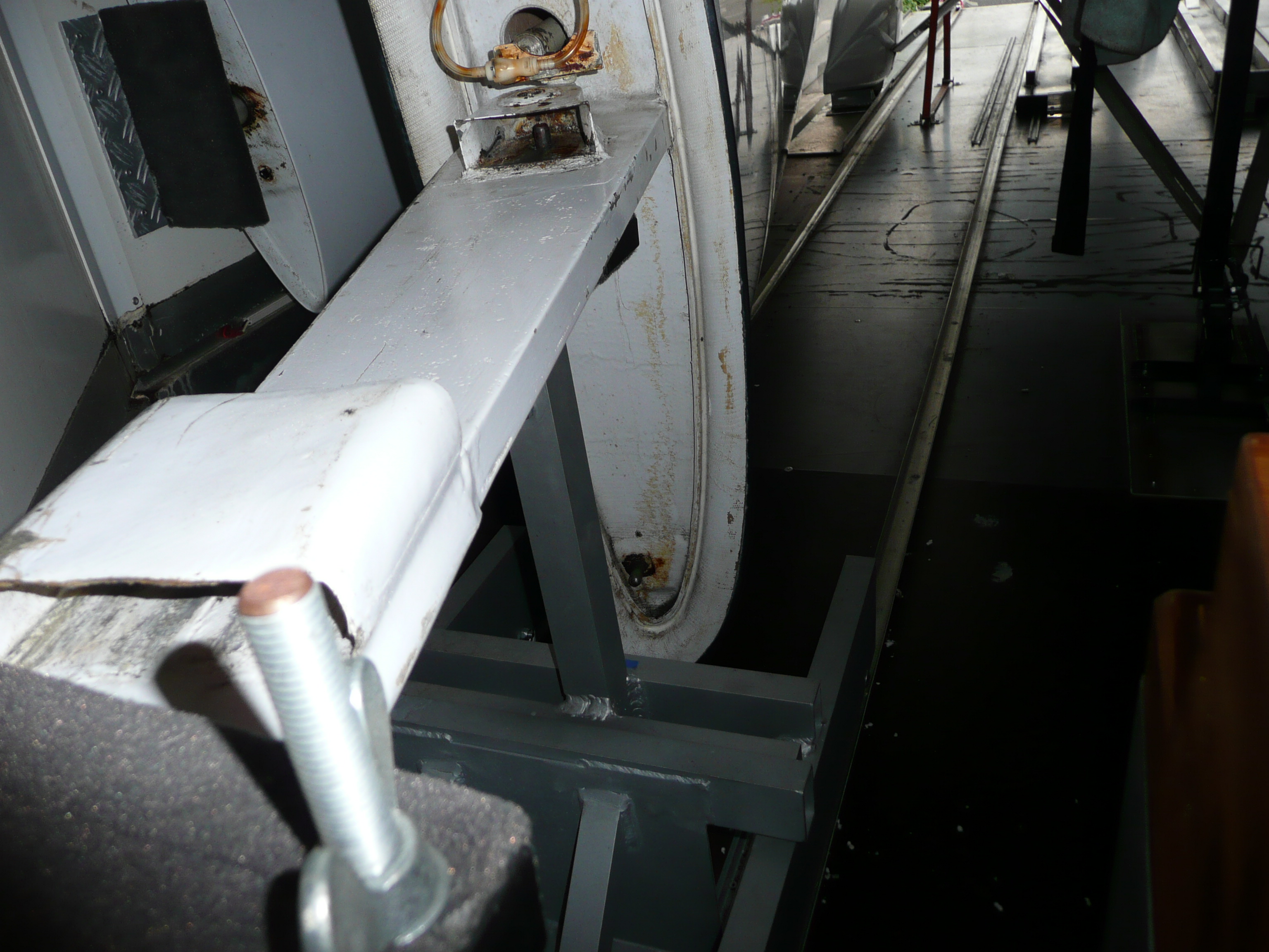

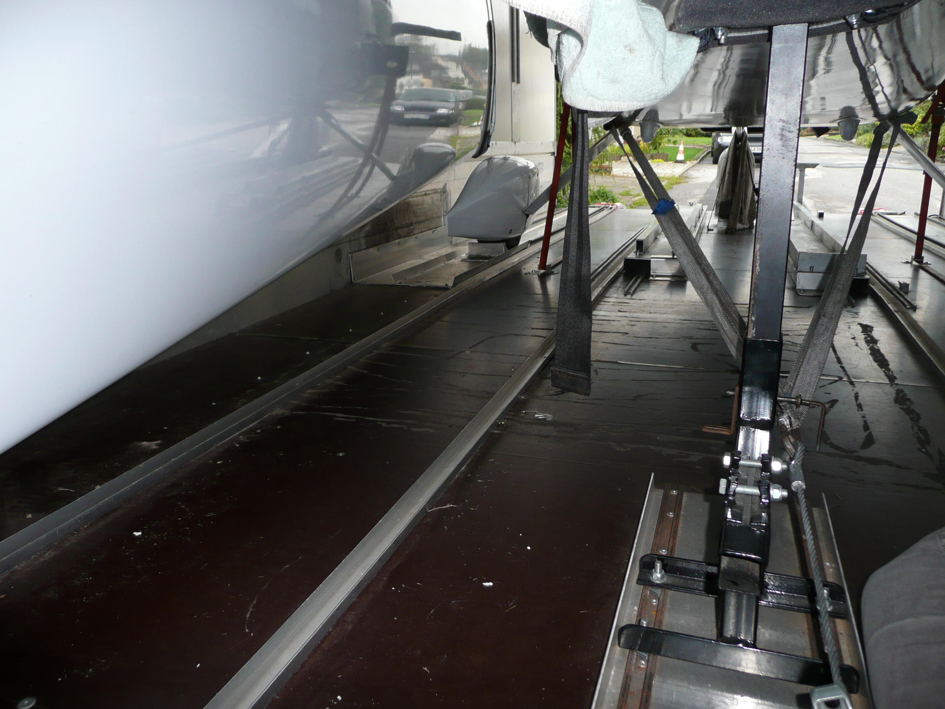

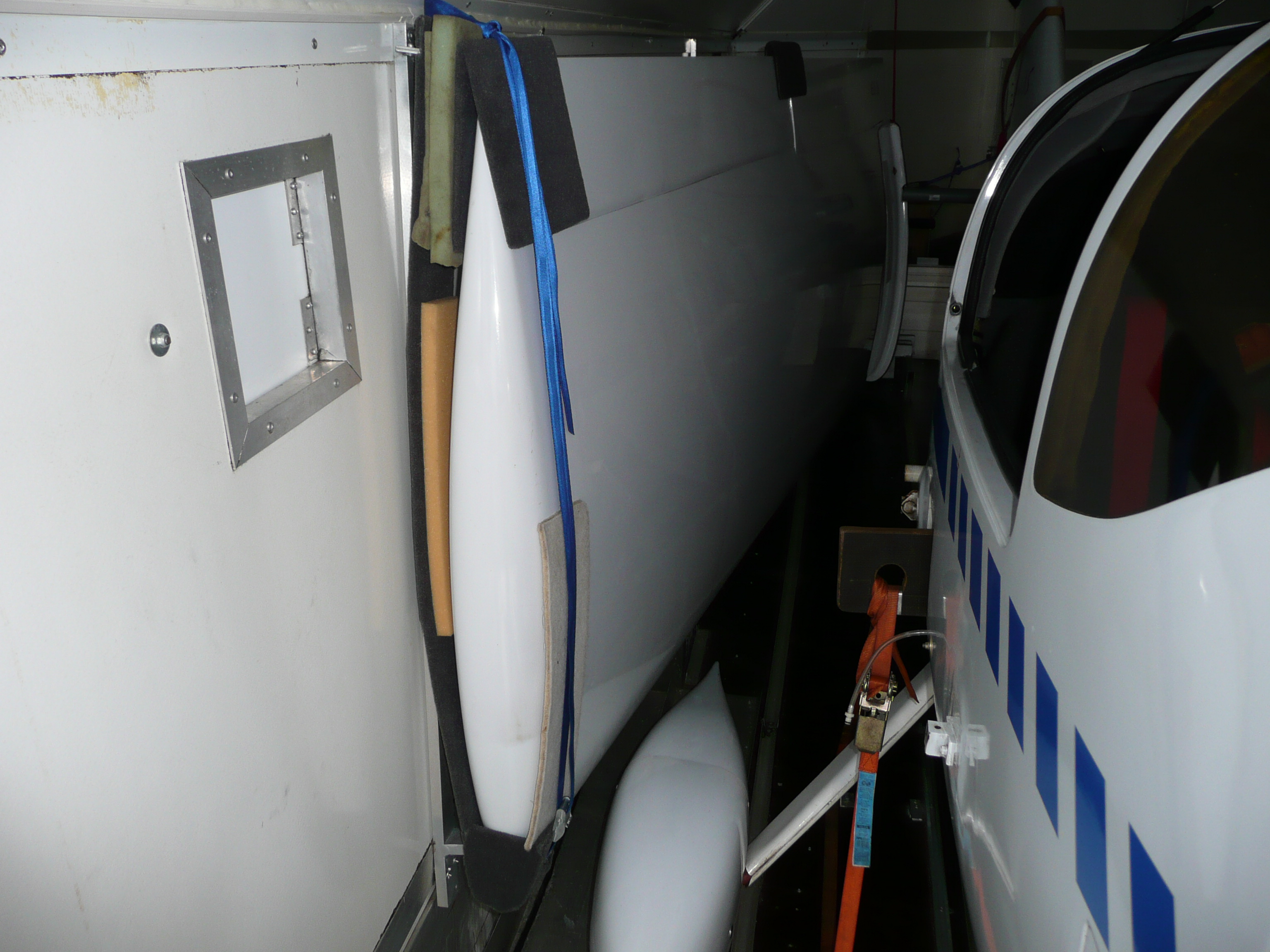

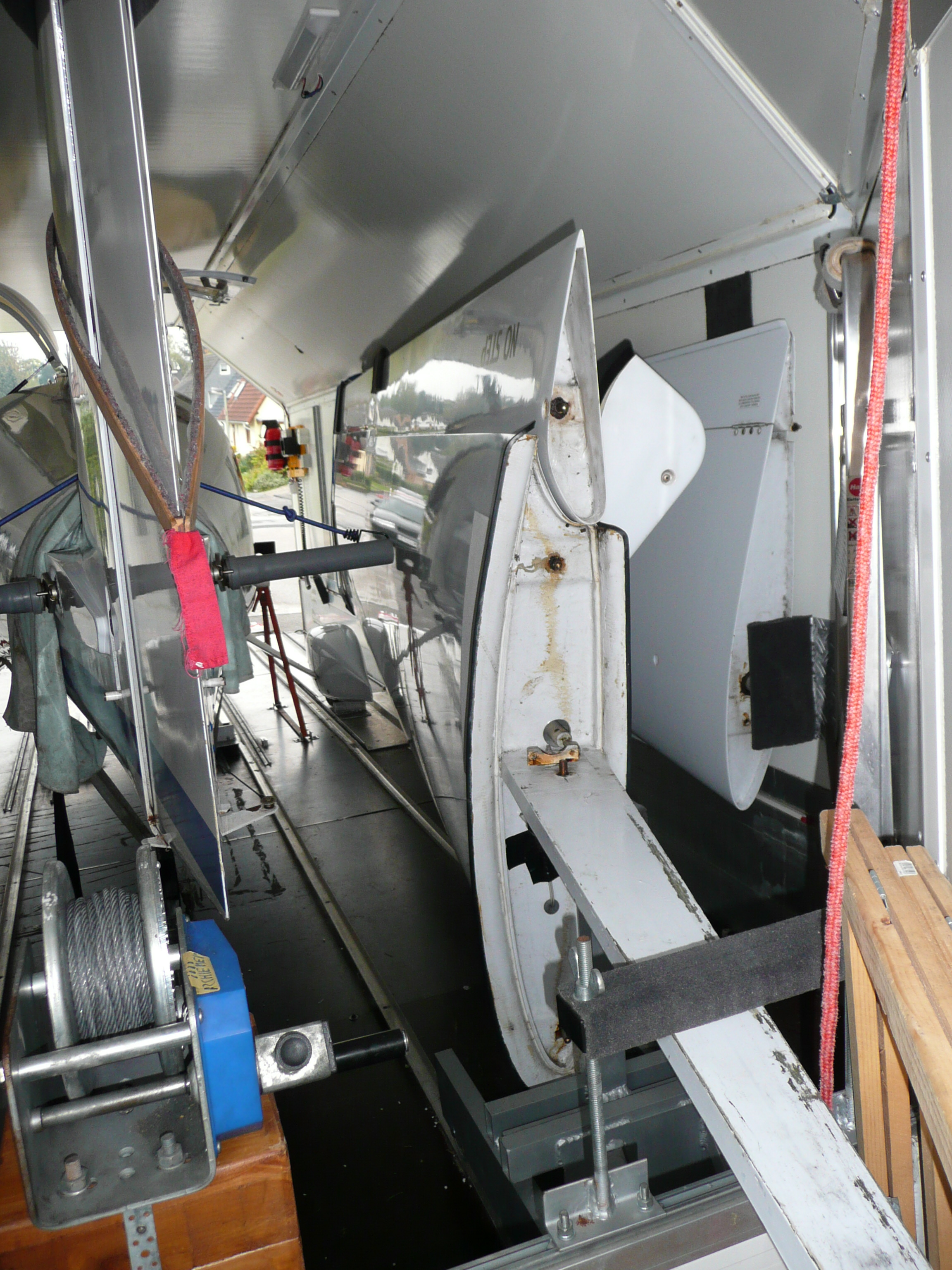

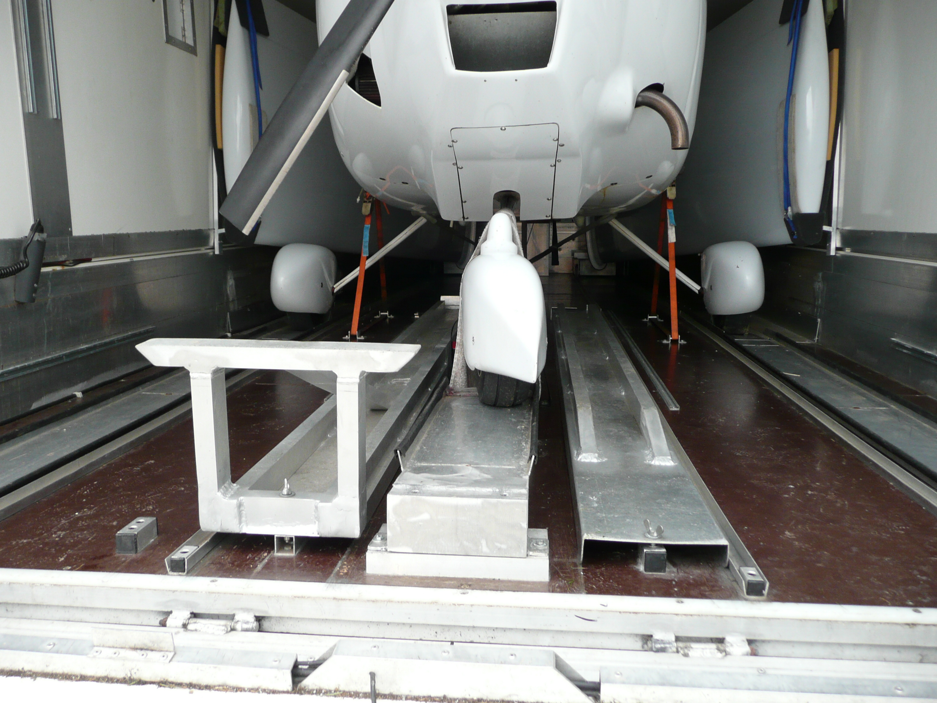

PostPosted: Fri Oct 16, 2015 10:27 am    Post subject: Re: Can someone send me a picture of a europa trailer pleas Reply with quote
Hi Will,
here come some more pictures from inside the trailer. However keep in mind, that you need to tilt the wings after sliding them out on their dollies. Thus I have another dolly on which I lay the wings and rotate them horizontally. Here you can see, how I do that
http://www.airport-data.com/aircraft/PH-ZTI.html
It takes me about 45 minutes to get the Europa ready for take off single hand.
Roland
