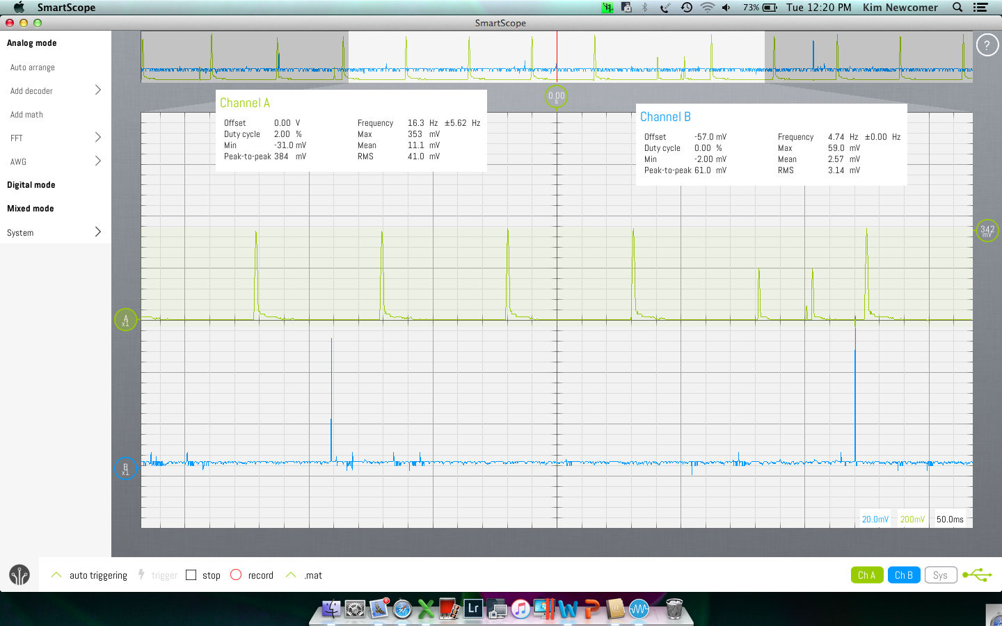

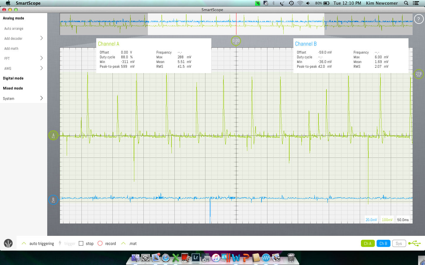

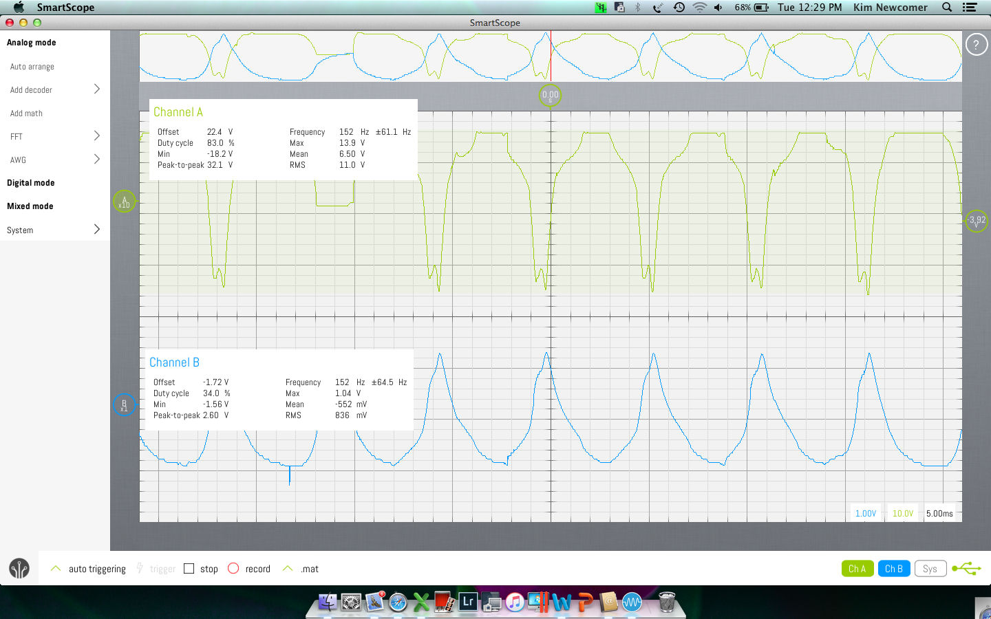

A brief problem description: I changed from a fried Key West voltage regulator on the front of my firewall to a Rotax VR on the back of my firewall. (Kitfox w/ 912ULS.) Now the music input to my intercom (SLA-400 TSO) is muted because of noise coming into the intercom via the IC-200 radio. So far I've shielded the input all the way to the VR, tried a noise filter right in front of the DC bus, and a faraday cage over the VR. I've improved the problem to the point that I can hear the music up to about 3000 rpm, then it mutes. So I bought an oscilloscope and took some measurements today. I'm seeing a weird 20Hz 360mv spike downstream of the VR, and the VR input (generator output) looks terrible. (I thought it was a kind of square wave.) I can't seem to find what the 912 generator output is supposed to look like online. Any ideas? Any ideas what the downstream voltage spikes are?
A trace - VR output voltage
B trace - Ground bus voltage
A trace - VR input voltage
B trace - VR input braid voltage
 Filesize:  217.6 KB
 Viewed:  10508 Time(s)
A trace - Voltage at main bus
 Filesize:  240.81 KB
Guy Buchanan
Deceased K-IV 1200
A glider pilot too.
PostPosted: Wed Sep 30, 2015 12:16 pm    Post subject: Rotax 912 Noisy Regulator Reply with quote
At 06:49 PM 9/29/2015, you wrote:
--> AeroElectric-List message posted by: "Guy Buchanan" <gebuchanan(at)cox.net>
The fact that you didn't have noise . . . an now you
do suggests a change in WIRING of the alternator
and rectifier/regulator. I'm guessing on where and
how the various components are grounded.
Electro-static shielding of wires, magnetic shielding
of the rectifier/regulator are almost guaranteed
to be no help with what appears to be a ground-loop
situation.
The 'noises' you observed are all quite normal
for the components of an engine driven power
generation system. The alternator is the most
trashy device in any airplane but the noise levels
are limited, known and easily managed in the
design of potential victims.
The now-you-have-it and then-you-didn't points
strongly FIRST toward a change in grounding
and SECOND toward an interference coupled
magnetically between adjacent wires bundled
together.
ALL potential victims (radios, nav, entertainment
systems should ground together ON the panel with
a single robust ground feeder extending down to
DC system grounds on the firewall. See View-A
of http://tinyurl.com/6m3bk8k
Bob . . . [quote][b]
