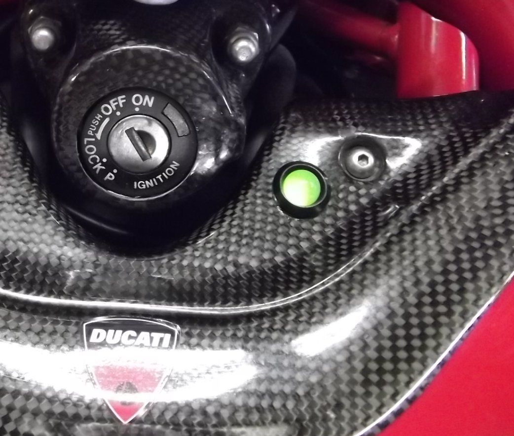

If I got stuck somewhere with a low battery, unable to start the 912ULS,
I would not be going anywhere.
I poke around in really remote areas on my various trail bikes. On some, and
especially on my road bikes, Honda scooters (250cc and 600cc) I like to
monitor the charging system. Hate to have it quit way out there. I can no
longer count on my body to walk back in. Long years ago I was a crew leader
on a FS hot-shot crew. Now... things are different. Oh- yeah, charging... I
install a lil LED thingee that shows the state of charge. I would
immediately know if my alternator stopped working or something. These are
cheap and easy to install. They show several levels of charge from flat to a
red blinking state for over-charging. It goes through off, orange, green,
red blinking red and maybe another. It's orange when I turn the ignition on.
That shows the battery is good but isn't being charged. Once running, one
gets used to the solid green (around 13.5v - 14.5 IIRC) and if it ever were
to change it would grab my attention quickly.

Here is one, much like mine, not exactly.
I bought my last one several years ago, still looking for that source in my records.
http://www.ebay.com/itm/12v-LED-Battery-charge-alternator-level-indicator-monitor-warning-light-lamp-E-/190401283689?hash=item2c54cd0669
This has dual-range which is nice if you use a trolling motor. Mine doesn't have this. Think mine is smaller in dia..
$16.98 + $2.99
Picture from eBay, not mine.
