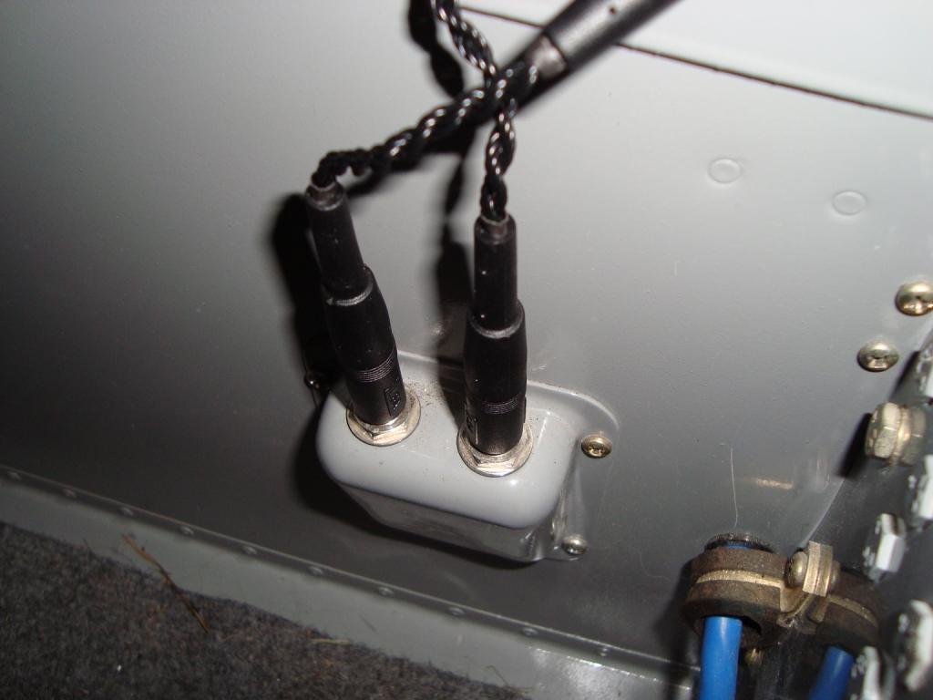

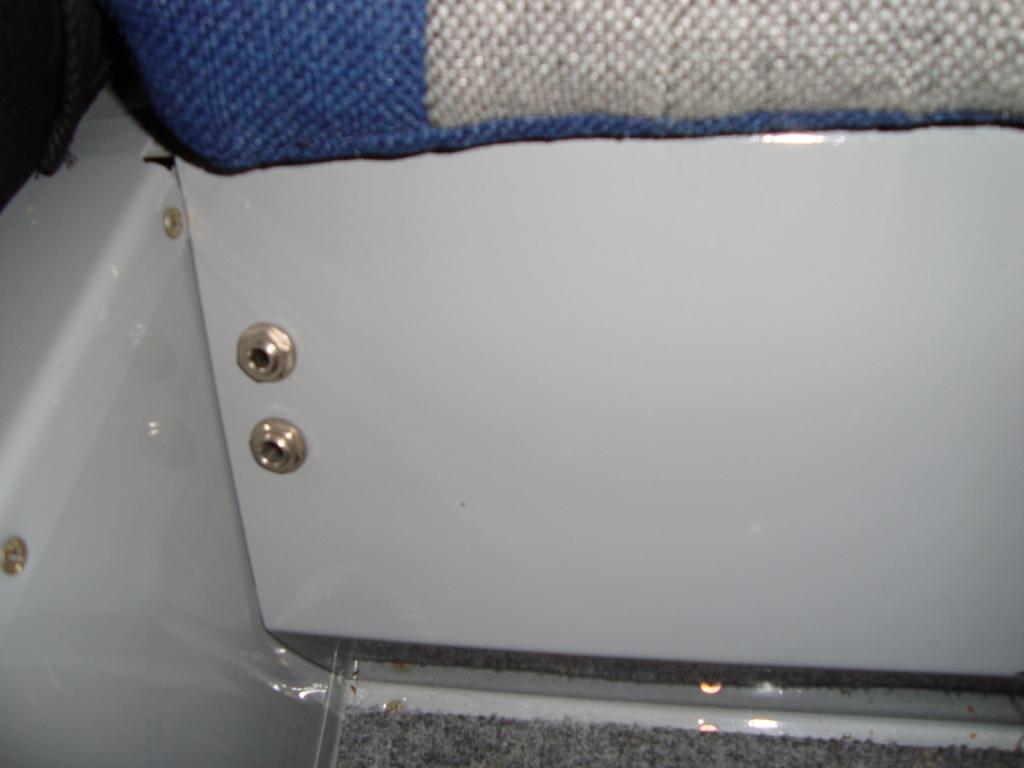

I wanted headset jack locations that did not force a headset cable to go
over a lap, or get kicked.

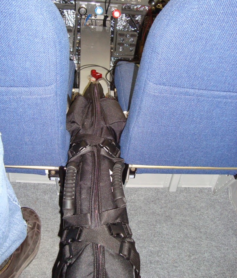

Oxygen is a AL-415 (14 cu-ft) cylinder from Mountain High mounted on the
tunnel cover. It is held in place by the case and straps it came with, the
straps attached under the appropriate tunnel cover screws. Very easy in and
out. I did a two week trip out west with a lot time at 13K-14K, two people
and used less than half of the bottle.
