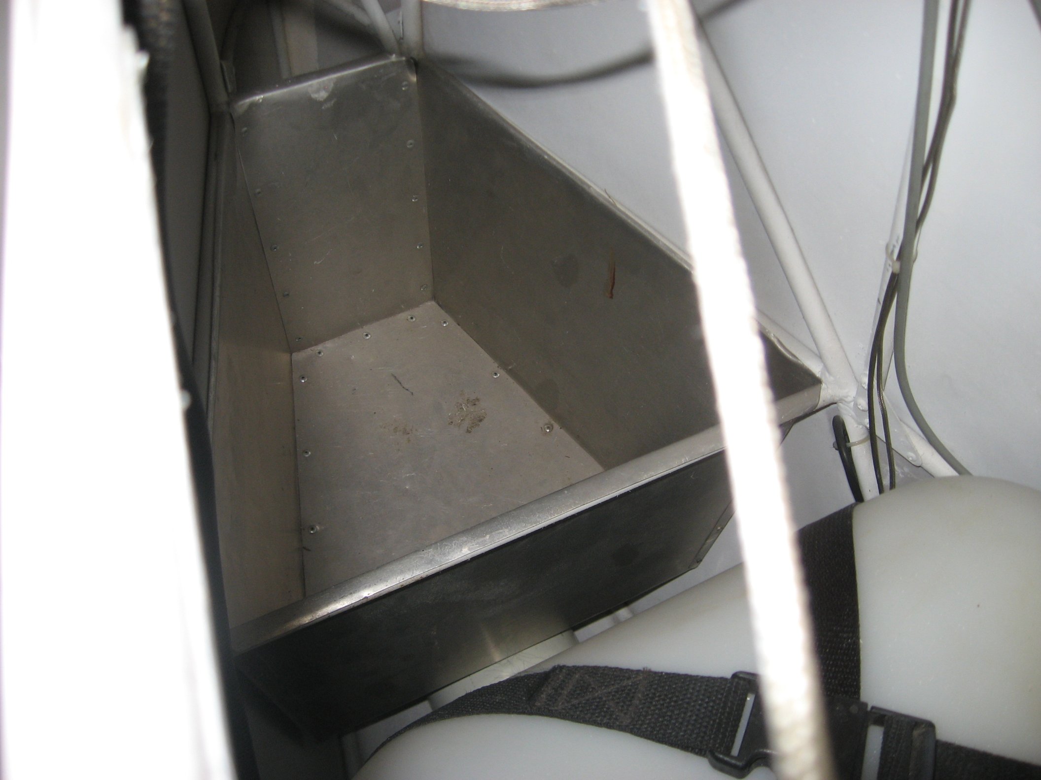

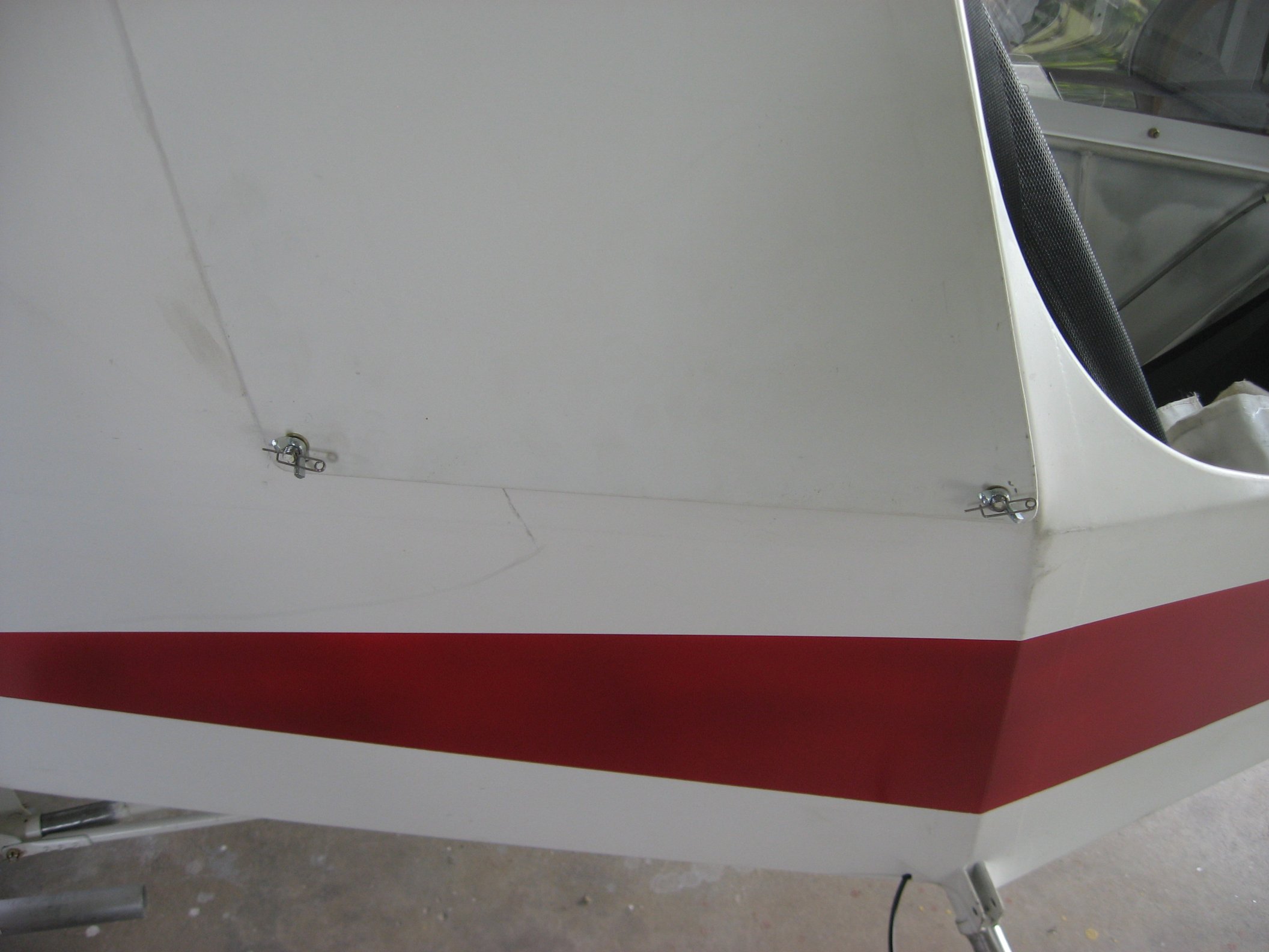

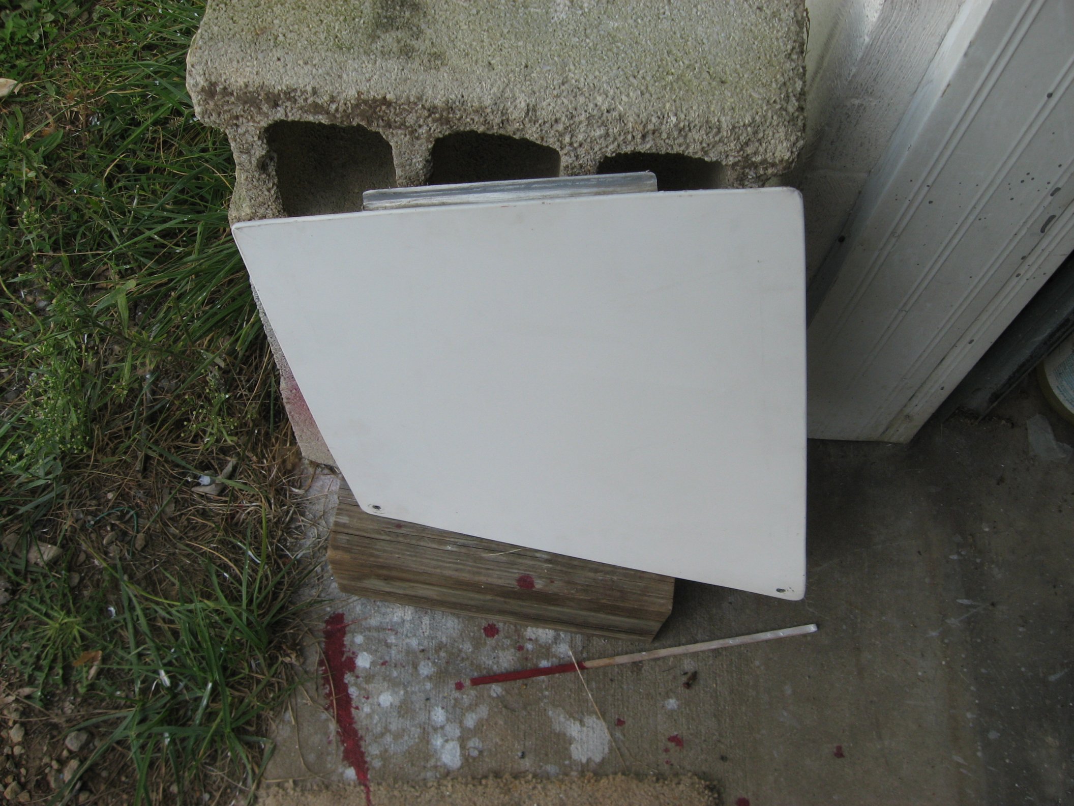

Thought I would send some pics , showing access to the fuel tank...also
one of the storage box just to the rear....naturally..one must be
careful adding too much wt to this compartment...Tie downs, oil and
maybe an empty fuel tank? The storage compartment needs a cover to
keep things contained in rough weather...Herb
