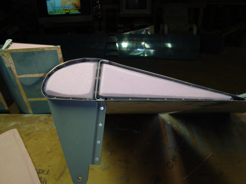

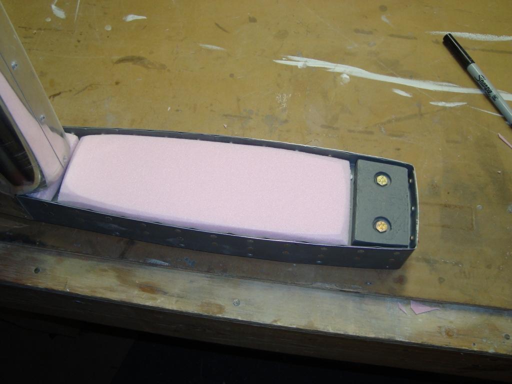

PostPosted: Tue Sep 22, 2015 5:48 am    Post subject: Filling and finishing empennage fiberglass tips Reply with quote
As with many things RV, this is squarely in the "builder's choice" column.
On my planes I first fill in the tip to skin seam with mico and then sand
flush. On top of this go a couple of bids of glass with peal ply as mico
alone between two different materials will tend to crack. On top of the
glass goes a skim layer of mico. Sand-prime-paint.
On all control surfaces, flaps, HS, VS and wing tips I took the very
unnecessary step to fill in the exposed ends. The attached photos show the
foam filler after being glued into the ends. Note the foam does not fill in
the full area. On top of this goes a few bids of glass such that the glass
edges go between the foam and the skin. The glass then supports itself -
the foam is just to form the glass. The glass is 1/32" to 1/16" below the
top of the skins to allow for micro on top to make flush. I left a 1/4"
weep hole in the trailing edge of all control surfaces to provide a path for
water to escape.
On the RV-8A and RV-10 I never had call to remove any fiberglass tip. The
wing tips of course are removable.
Carl
