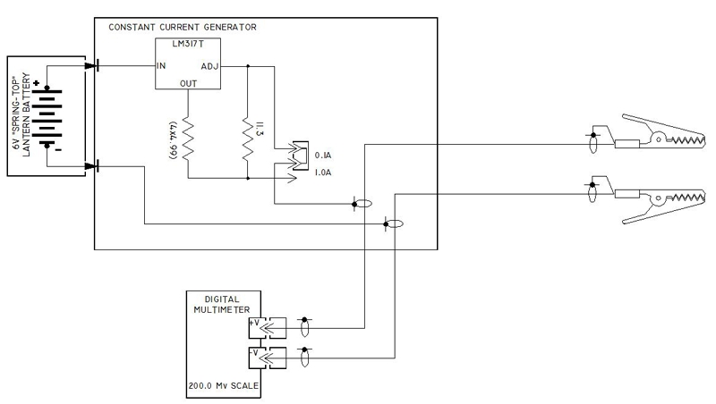

The LM337 being a negative regulator, can this circuit be used by reversing the battery polarity, or there other issues?

Bob,
I am interested in constructing a low resistance measurement adaptor.  I have a LM337.  Can I use this device, in place of the LM317, with a small modification to your schematic?
Roger
  Sure, any of the 3-terminal, adjustable regulators
  can be adapted to this service. Here's the schematic
  for the AEC9008-3 adapter
[img]cid:7.1.0.9.0.20150916132723.0609fe38(at)aeroelectric.com.0[/img]
  If you choose to include the 1.0 Amp excitation
  option, be aware that the regulator chip warms
  up rapidly. Make QUICK measurements or include
  appropriate heat sink. 0.1A measurements
  require no heat-sink.
