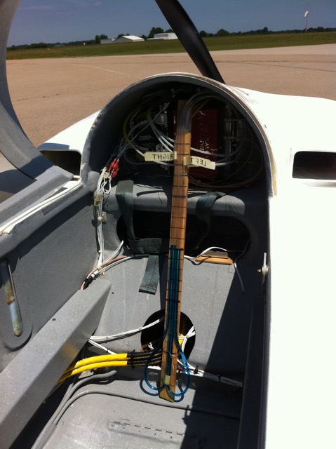

PostPosted: Wed Sep 16, 2015 5:10 am    Post subject: Low Air Pressure Sensor Reply with quote
Jared, Maybe you only need to measure the pressure differential above and blow the cylinders. Lycoming recommends about 5” of water differential, depending on HP. This discussion on the Van’s site gave me the idea for a good manometer arrangement. I used it to run some tests on a Long-ez that were informative.http://www.vansairforce.com/community/showthread.php?p=978583-Kent

PostPosted: Wed Sep 16, 2015 5:46 am    Post subject: Low Air Pressure Sensor Reply with quote
Thanks for the help!  In this case I'm wanting to measure the differential before and after the oil cooler, but I'd also like to check above and below the cylinders eventually.  I hadn't considered the manometer, but I'll look into that.

PostPosted: Wed Sep 16, 2015 6:03 am    Post subject: Low Air Pressure Sensor Reply with quote
Many RVs in hot climates have issues with oil cooling. Solutions have
included larger or more efficient coolers, in a few cases adding a
second cooler. If the cooler is fed from the rear baffle by scat tubing.
the differential will be a bit less than the differential above and
below the cylinders, due to losses in the scat tubing and the drop
through the cooler.
-Kent
> -Kent
