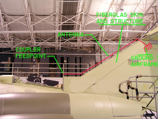

But if it's any consolation, I've encountered
ONLY ONE EMC problem on an airplane wherein
root cause could NOT be resolved . . . only
swapped out.
[img]cid:.0[/img]
Seems that some really nifty technology advances
in communications hardware were installed
on an aircraft being manufactured to still
adequate methods designed 40 years ago.
A technology that placed NEW and exceedingly
difficult requirements on the airframe.
From that time to this day, the aircraft has
suffered a host of EMC problems that occur
at intervals, sometimes in small batches,
and will never be resolved except that the
old wire-type antennas be re-installed.
I'm not suggesting that your situation is
intractable . . . only that not all combinations
of hardware are plug-n-play in all airframes
and yours is fixable.
Only spent a few hundred $K tracking the
other one down . . . yours will be MUCH
less expensive.
