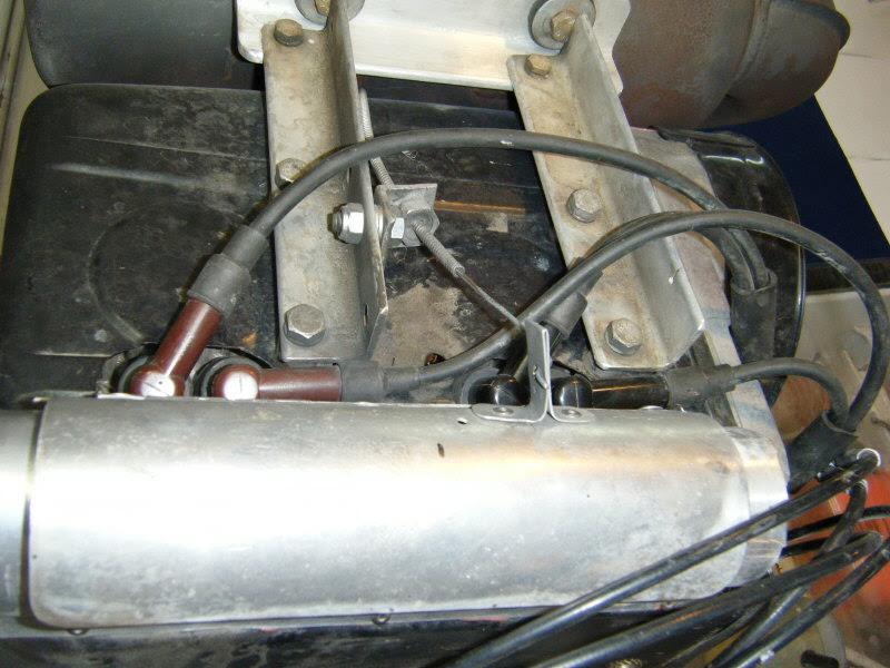

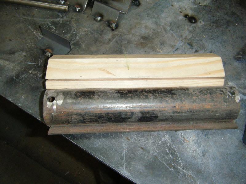

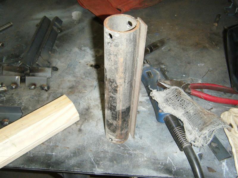

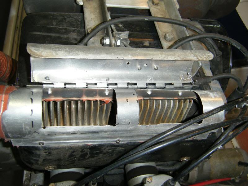

You are lucky, I managed to find the pictures on my wife's computer.
The way the heater works is that it captures the hot air coming out of the shroud and is funneled into a scat tube that I ran to the nose pod. In the image- Tools to bend- I used a 1 1/2 or 2 inch chunk of pipe with a thin piece of flat stock welded to the pipe to hold the aluminum that will make up the tube. I drilled a hole in the end to stick a piece of 3/8 rod to give me leverage enough to bend the piece. I left the alum about three inches longer than the opening in the shroud so that I could fit the scat tubing over it. The next picture- tools for flanges- is merely a piece of 2x4 with a kerf cut about 1/2 inch deep is to bend enough of the tubing into a flange so that you can rivet it to the shroud. I then cut a circle that I could close off one end of the tube. In the picture- heater open you can see that I cut out panels so that I could allow all the heat to escape if I didn't need it. I used a push pull cable to activate the door, and I placed that in the cockpit. Once you get it made, put down a strip of high temp silicone sealer and rivet it to the shroud.
Even with the back of the enclosure open I was able to fly mine all winter long and still be able to stay pretty comfortable.
If any of this is not plain, feel free to ask for clarification.
