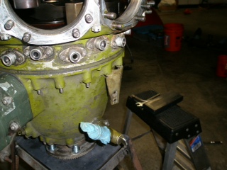

This is what we used to teardown my YAK 50 engine. Mounted the stand to the prop flange.

The prop on the Housai engine has a splined flange that can be unbolted from the main hub. Find an old, unairworthy prop, remove flange and bolt the flange to the stand. Kinda like an old A-65 Continental prop flange.

Thank you Doc, Marcus and Elmar. I think I know where to go from here. Again, thanks for sharing your experience.
