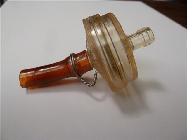

Glad to be of assistance. Keep in mind that if you use two fuel lines the check valve is going to have to be in the other line, not where the two lines converge into one.Good luck
Larry

PostPosted: Mon Aug 17, 2015 5:18 am    Post subject: Re: Primer Bulb Reply with quote
Hate to be the duty curmudgeon, but I had a couple problems with Heavenbound Aviation's guide.
One is that he pictures a fuel filter with a paper filtering element. Will that still allow gas to flow through it if it gets a dose of water?
If you use a good quality filter in your tank, then you can use an inline bronze filter in a transparent case with out any worries. The best tank filter/pickup is a replacement for the ones that go on in-tank car fuel pumps, they are fine mesh nylon, very large with lots of surface area, and pretty cheap.
His description and pictures of using safety wire as a fuel line clamp is simply wrong. He uses one wrap and a straight twist. One wrap fails to secure part of one side, and a straight end is a good way to jab yourself and bleed all over your airplane every time you get near your fuel system. Double wrap and bend the end over like in the attached photo. (found that old filter & line in the scrap bin)
Finally, I suggest never using blue urethane line for anything, period. Soft aluminum fuel line from Aircraft Spruce is cheaper and lasts forever if properly installed. Blue urethane can look good and feel soft, and break without warning. (Guess how I know this?) Good grade NAPA fuel line will still look good on the outside after many years and does not deteriorate, I use that where the aluminum line ends to connect to the carbs, fuel pump, etc.
Worth what ya paid for it.
