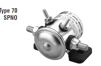

The legacy "beer-barrel" contactors are
large area, low pressure switching devices.
[img]cid:.0[/img]
http://tinyurl.com/5uh3b8
The highest risk for failure is corrosion
since these are not a sealed device and
the contacts are pure . . . or nearly pure
copper.
http://tinyurl.com/pw342c3

This style of contactor is the LEAST expensive
product suited to our task but as such, it can
be expected to have a shorter service life than
say a hermetically sealed, $high$ contactor.

The $24 contactor
http://tinyurl.com/nzern26
Is guaranteed to offer a lower cost per
flight-hour than these oft recommened
upgrades . . .
Tyco EV200 . . . which is a bit 'noisy'
http://tinyurl.com/qyexahd
http://tinyurl.com/p2uwagu
or a Gigavac GX-11 noise free . . .
http://tinyurl.com/qa9m9ne
http://tinyurl.com/pdknjb2
