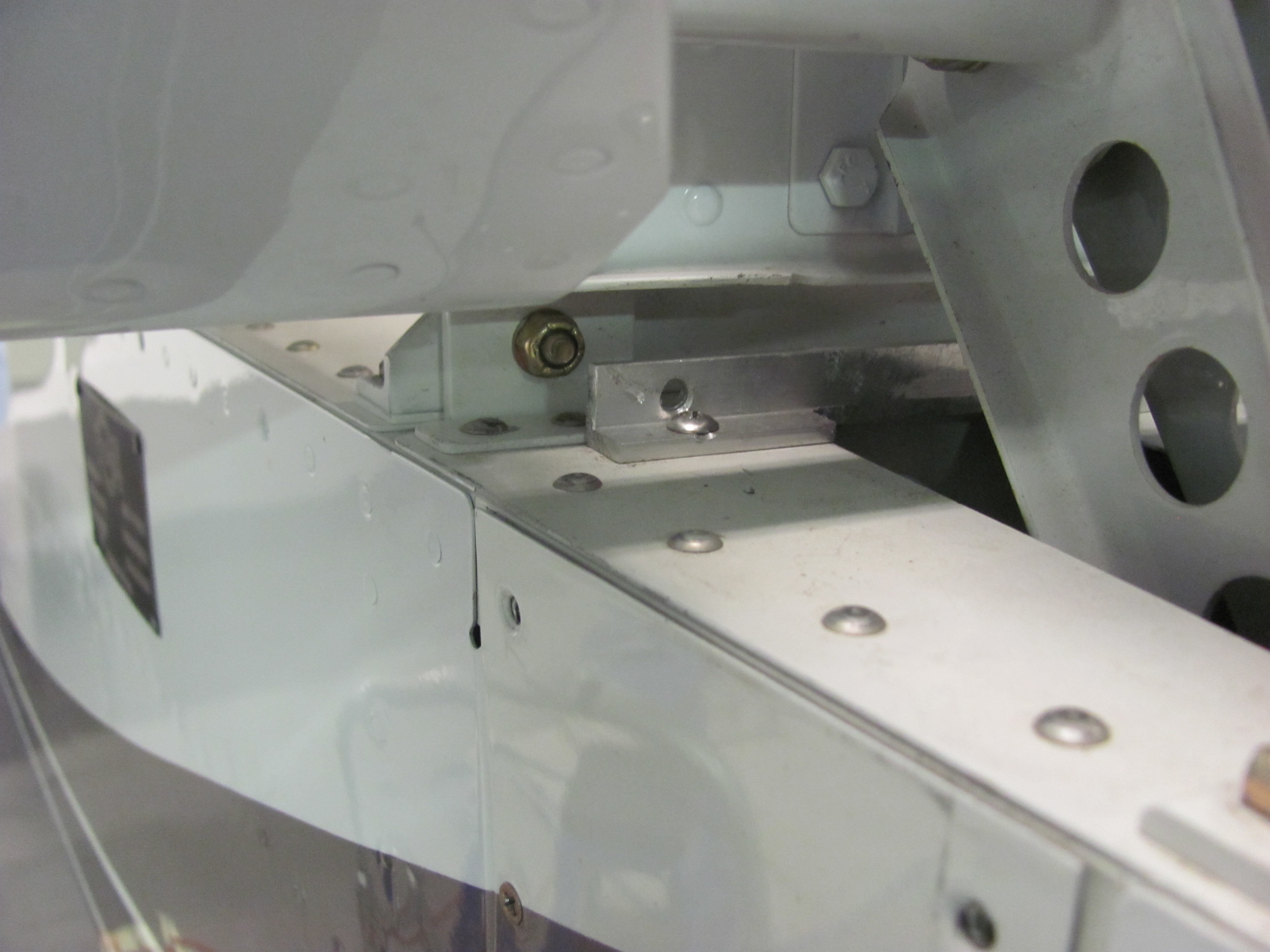

I would like to limit my elevator down travel ever so slightly (about a 1/4 inch of stick travel.). I'd like to query this fabulous brain trust on the preferred method to accomplish that. [/b]

Myron
This came from I think Deems but it works really good. It's a piece ok angle
aluminum with a notch cut to required
Stop. Use 2 10/32 screws or bolts with lock nuts.

I did the same thing, works like a charm
