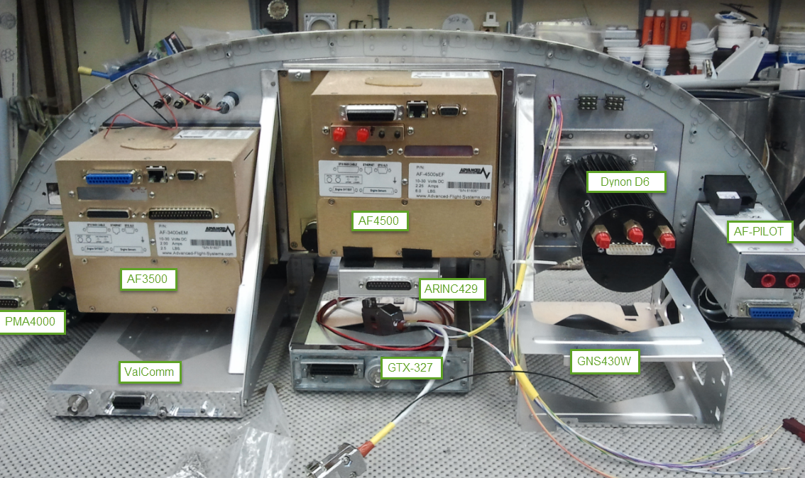

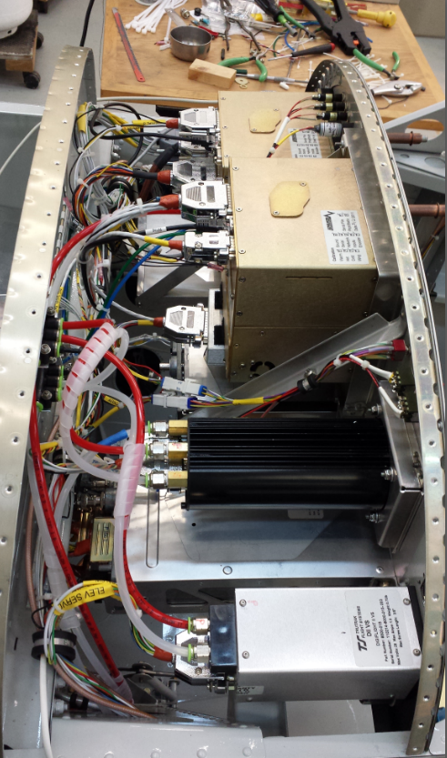

Hello Charlie,
My -8 panel is holds a 430W, AF4500, ARINC module, AF3500 and AF-pilot.
I followed the AFS wiring schematic exactly.  No shielded cables except for the run to the magnetometer and serial port connections.  All remaining connections between the ARINC 429 module, the 430 and the AF4500 are AWG22 single wire bundled into a harness with zip ties.
I attached the ARINC 429 box to the underside of the AF4500 with self adhering velcro.  Thus all signal wire runs are short, less than 24 inches.
System works flawlessly.
[img]cid:ii_14ecfd370fb563ec[/img]
[img]cid:ii_14ecfd7d06404a00[/img]

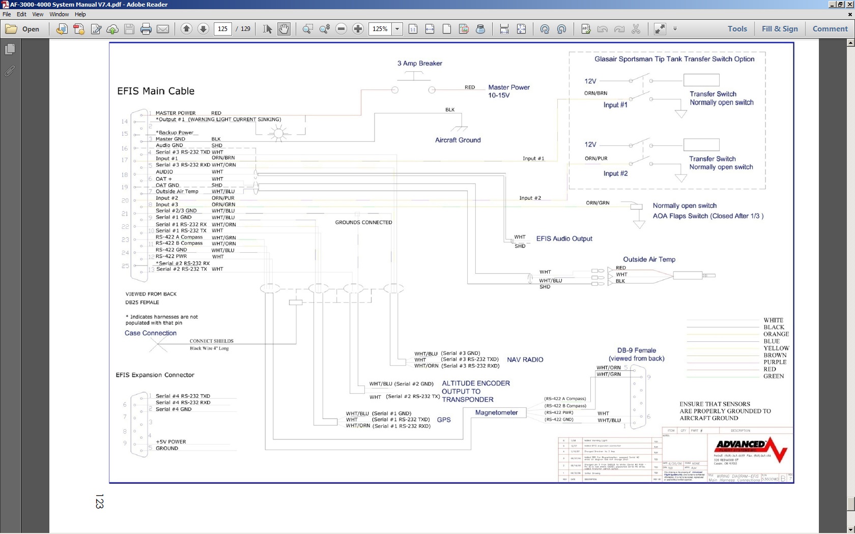

Understand about Belfoil shielded wire; I've built my share of cables using it in one of my previous lives as a sound engineer & audio tech. It's unrelated to my question. As a reminder, my question is about the AFS *documents*, not actual wire. I should have attached an image of the diagram with the 1st post. Image attached now.
See the wiring from the 'EFIS Main Cable' connector to the Nav Radio, Altitude Encoder Output to Transponder, GPS, and Magnetometer. All are shown with a separate ground wire, drawn within the shield. None of the devices draw significant current, and all the 'ground' return pins shown in the EFIS Main Connector are electrically common to the chassis of the EFIS itself. My question is about the 'extra' ground wire, drawn within the shield for each of these destinations.
The only connection that does make sense to me is the 'EFIS Audio Output', which logically shows a signal wire and a shield return, without the extra ground wire.

rossmickey(at)comcast.net
PostPosted: Thu Jul 30, 2015 12:50 pm    Post subject: ARINC 429 wiring practices Reply with quote
I just got done installing a 5600.  I wired it as shown.  Each Serial Port bundle has a RX, TX, Gnd and shield.  The shields for the four ports are all connected together at the main harness connector with a black wire coming out of the connector that gets grounded to the chassis.    I used whatever TX, RX wires I needed for the particular instrument.  I ran all of the Gnd wires to my ground block since that is where all of my instruments are grounded.  Everything works great ever since I got rid of the 18” length of unused OAT cable.
If your question is why they want us to ground each serial port, I can’t tell you.  I just did it.  Have you called AFS and asked them?
Ross
N9PT
On Thu, Jul 30, 2015 at 8:48 AM, Robert L. Nuckolls, III <nuckolls.bob(at)aeroelectric.com (nuckolls.bob(at)aeroelectric.com)> wrote:
At 04:34 PM 7/27/2015, you wrote:
Thanks to David & Bob.Â
Bob,
My question about the 'extra' ground wire was related to the serial port(s), not ARINC. IIRC, serial stuff is typically unbalanced, with a signal line and a shield/ground return. In the case of the AFS docs, they show in one case (to external GPS) a pair of signal wires (bi-directional data), and a ground wire, all wrapped in a shield. In another case (magnetometer) they show a pair of RS422 signal wires, a power wire, and a ground wire, all wrapped in a shield. That's the practice of embedding an extra ground wire inside a shield (when the shield can serve as ground) that I was really questioning.
The 'extra' wire you're describing . . . is it bare?
. . . and what is the nature of the shield material?
. . . what you are describing is reminiscent
of a product from Belden Wire called "Beldfoil"
shielded wire. Instead of braiding strands of wire
over the bundle, they wrap an aluminum foil shield
over it. VERY effective shielding but electrical
connection to thin aluminum is hard to make up.
The solution was to bundle a bare stranded wire
in with the other wires. Given that it is not
insulated, it makes connection with the shielding
at innumerable places along the length of the cable.
http://tinyurl.com/nhpjmup
Given that electro-static shield currents are
very low, it matters not that the ground connection
to the foil is not gas-tight. Hence, the shield ground
has a hi order of integrity to the task and the foil
shielding is electro-statically superior and much
less expensive than braid . . . a kind of win-win.
Unfortunately, this technology is not generally
offered in combination with our favorite insulations
so you don't see this wire used in TC or military
aircraft . . . but it's fine for our purposes.
That 'extra' wire CAN be used as a part of the
power path as long as it's 22AWG current ratings
are observed . . . with the caveat that the
return path power wire be included in the bundle
so that you get parallel path cancellation for
electro-magnetic coupling. But as a general rule,
you're almost never wrong to use the shield
for electro-static decoupling and attach it
to ground one time only at either end.
