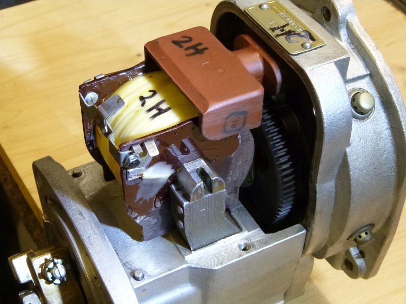

Jill/All,
Recent threads on the subject of mag problems and total cuts in flights etc. suggest changing the mag coil cures the problem.
I’ve recently changed one on my M14P Yak52, only to be presented with the same problem again on the replaced coil. (Everything else has been checked out).
Discussions with various people seem to point to it being an ”age” breakdown problem with the coils rather than a “amount of use” problem.
So, the question is, does anyone have a supply of KNOWN GOOD coils that can be used as a replacement?
If anyone DOES, can they let me know price including shipping to the UK? Or, and alternative source of supply (Termikas tell me “not available” and “unable to overhaul”).
Thanks in advance everyone…

You say that the problem continued with a "new" coil – I suspect you have anticipated the problem yourself in that I suspect the replacement coil was also not working well.
After almost 30 years with these engines, I can say that almost any high-tension ignition problem does come down to magneto coils or, on occasions, the high-tension wiring.
Coils are a significant problem. M 14 P Inc are making new ones, as we in Hungary. We know that ours are perfect, but our level of production is such that we need to reserve most of them for our engine overhaul customers, but can supply some to others if they want.
If anyone is interested, please come back to me off list.

None of my business Nigel, but if you don't mind I'd like to ask a question.
Assuming your engine is having "total cuts in flight", and you know which mag you think is causing the problem, have you ever turned that mag completely OFF with the mag switch and tested to see if the condition continues?
And another suggestion that may sound rather dumb, but ...... .
I have seen the wiring to the mag switch reversed on more than one occasion. This obviously can lead the owner to think the wrong mag is bad. Simply put an ohm-meter on the P lead and check to see which switch position grounds it JUST TO BE SURE.
My 2 cents only.

Thanks Mark. Yes, p-leads have been traced to ensure correct mag was looked at. And when I say total cut, I had a rough engine, and selected mags individually in flight to see which was causing the problem. On mag2, got a total cut. Mag1 ran fine.

Nigel,
Did you verify the points are opening and closing properly and set to
.25-.35mm? See if the foot of the points is still there and not worn
down to where it does not contact the point cam. Poor lubrication of
the cam causes the foot to wear significantly. If the points are not
opening, the mag will not fire.
Did you check the high voltage stick to make sure it was not arcing to
ground on the side of it? Sometimes the high voltage stick is cracked.
Especially right around the part of the stick that is protruding just
above the hole in fits into. If it cracks, the voltage from the coil
will never make it to the cap because it is arcing to ground.

PostPosted: Mon Jul 27, 2015 1:53 pm    Post subject: Re: M14P mag coils (YAk52) Reply with quote
Hi all,
I had some inflight "entertainment" with these coils in past two years as well. Seems that is age-related plus heat sensitive. Recently I had put two "good" coils on the Yak but the flight test produced great cut-outs once again after minimum half an hour in the air. So I put them in the oven at 75 degrees Celsius for 3 hours and yes, as expected, spark length reduced from half an inch cold to around 4mm to max 7mm hot, so not acceptable !
I had rewinds last year with no heat variation on spark length, be it cold or hot, capacitor external, car type. But I did not like the thin spark after the rewind, around half an inch length was OK though. So just now there are two fresh poor coils for rewind, will tell results then.
So in the present case I´d suggest putting the mags in the oven and see after 3 hours what they do. I guess you will find unacceptable sparks for operation. As I see it, the Russian coils with their coating on the windings and the internal capacitor may age so I will not fit any coil again as long as I do not know when it was produced. Besides, helicopter engines with M 14 radials had extra cooling ducts for both mags !!
So no need for a lot of head scratching about other spark shorting out anywhere in the mag: Try another coil in your mag in both conditions, cold and hot and see yourself: A good/modern coil will get you a long fat spark in warm mode whereas a bad coil will fail this test with all the rest of the mag being the same components.
Good luck with that one
