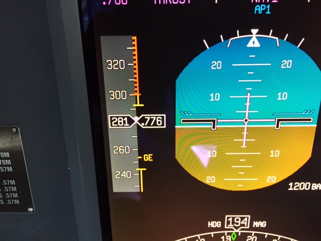

PostPosted: Tue Jul 28, 2015 8:41 am    Post subject: V Speeds Reply with quote
Here's what coffin's corner looks like on a PFD: http://www.pbase.com/flying_dutchman/image/124628692
It's a pretty routine scenario for airliners as we try to fly as high as we safely can to save on fuel.  Not a lot of margin, and it's not a good idea to hand-fly at those altitudes.  Or to fly too close to thunderstorms.
Not a problem in an RV-10 as you just can't get high enough.

PostPosted: Wed Jul 29, 2015 5:58 pm    Post subject: Re: V Speeds Reply with quote
Y'all were talking about the coffin corner and thought you might like to have a visual. In this photo, the yellow bars on the speed tape represent Mach buffet above and stall below the indicated airspeed. We were not at our altitude ceiling, but as you climb, the two yellow bars get closer to the airspeed. At our ceiling, there is only a few knots above or below. Also note the blue PLI (pitch limit indicator). It is only a few degrees above the current pitch in level flight. That PLI it where the stick shaker activates...
 Filesize:  94.29 KB
 Viewed:  11797 Time(s)
