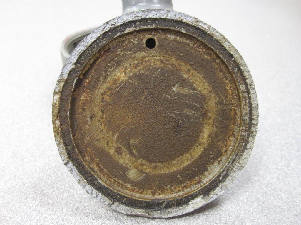

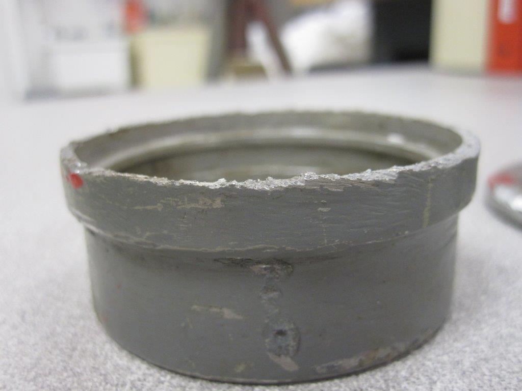

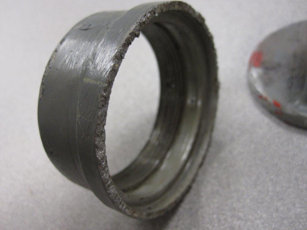

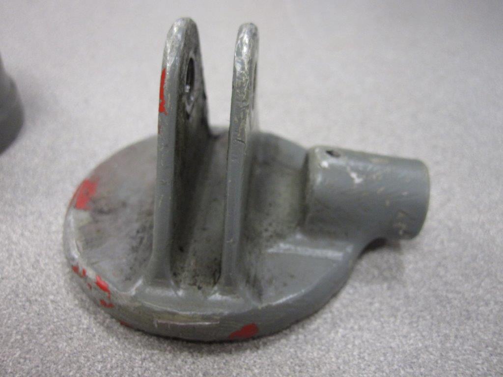

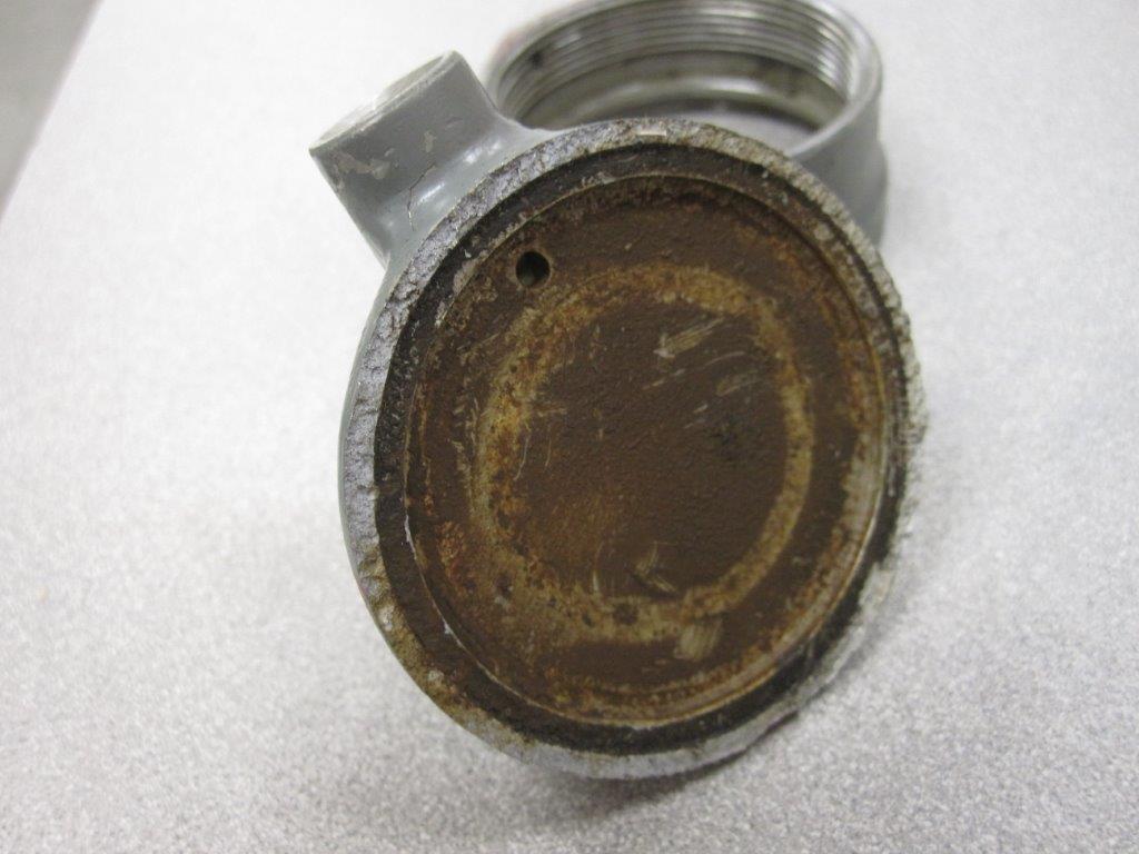

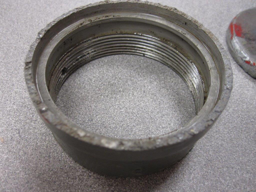

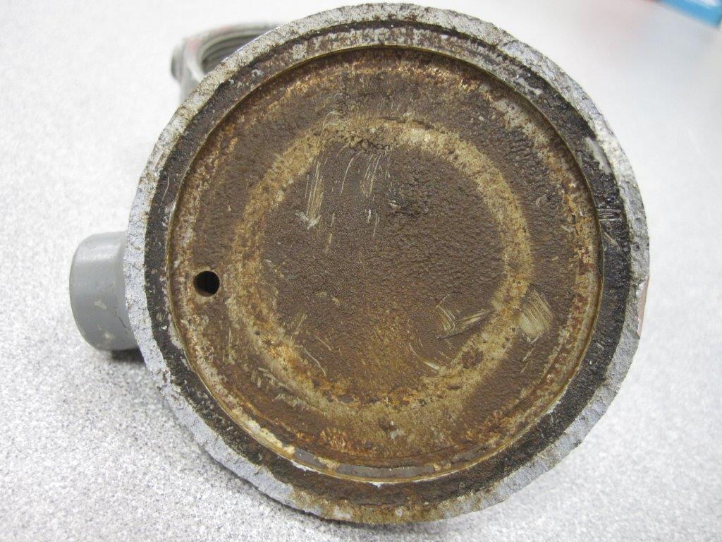

PostPosted: Fri Jul 24, 2015 10:28 am    Post subject: YAK-50 landing gear actuators overhaul time. Reply with quote
Attached are photos, sent to me by Jill, of the end of the left landing gear actuator end that blew off at 300 lbs pressure in the shop at M-14P inc.
Gord
