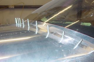

I went a different route, and am very happy with it. I used a piece of shaped aluminum, instead.
John
